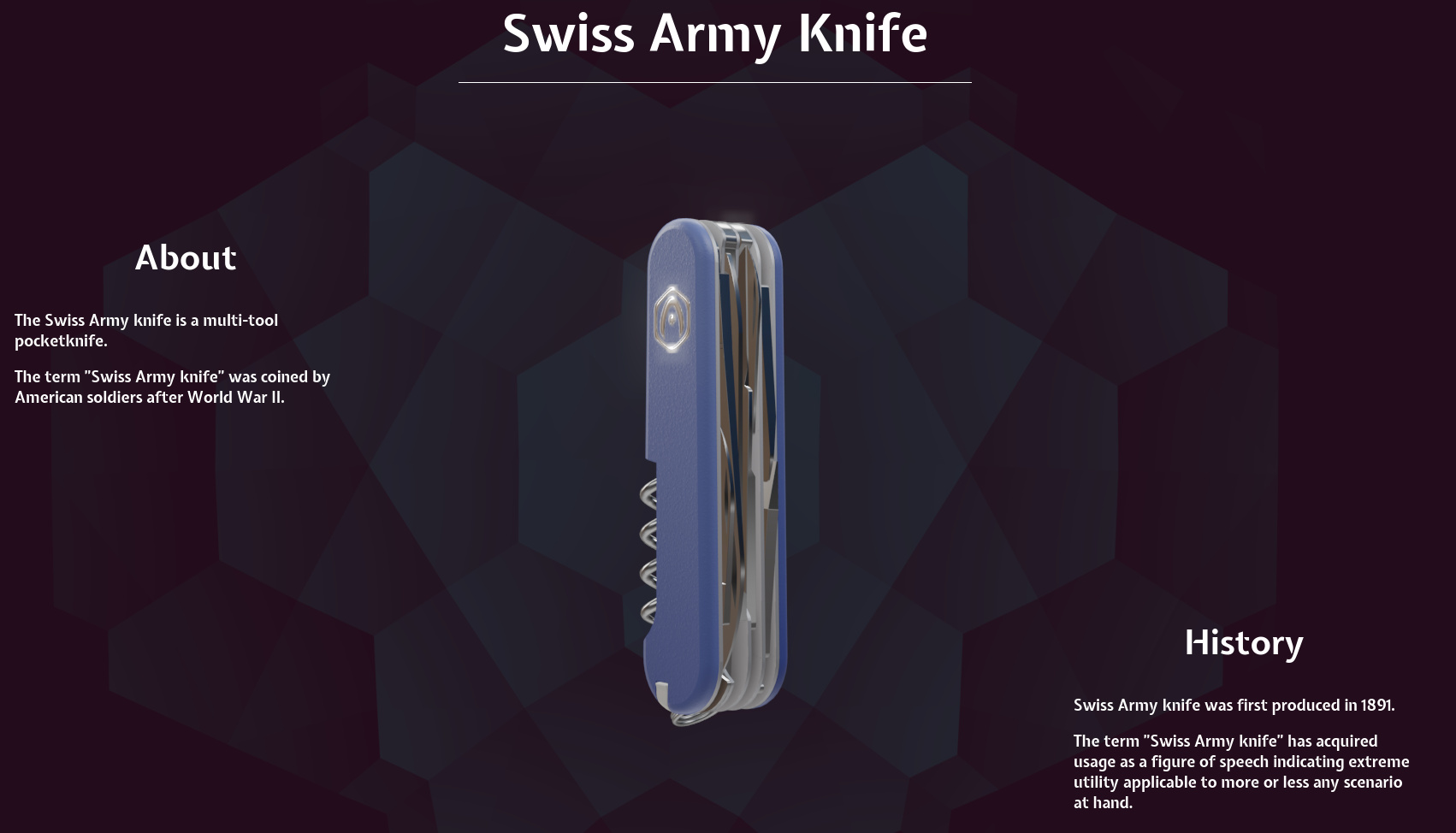

The event puzzle obtained a new option – scroll, while the get event property puzzle was supplemented with the scrollX and scrollY properties.
As a result, you can now track the scroll amount from the user, thus making possible to implement interesting applications that show transitions in the 3D scene according to scroll bar position.
Take a look at the demo (tentatively called Swiss Army Knife Scroll), in which the scroll amount affects animations, camera position and color changes.
In order to make the scroll bars appear, you should set
overflow: visible;for the body tag inyour_app.cssfile. Also in this file you should specifyposition: fixed;(as opposed to absolute) for thev3d-containerelement so that the 3D canvas preserves its position while the user scrolls the page.Puzzles

illussimoCustomerThe swiss army knife scroll demo is fantastic! An extensive example of what can be achieved with this feature.

Is it possible to share the complete demo of the Scroll transition effect please.2020-09-07 at 1:01 pm #32533vivektrivedi478
The demo should be in Verge3D’s stock examples, named Swiss Army Knife Scroll.
