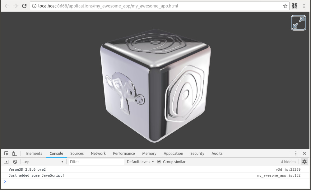

function runCode(app, puzzles) {
// add your code here, e.g. console.log('Hello, World!');
console.log('Just added some JavaScript!');

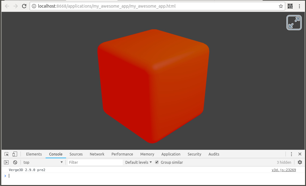

Now, if you save the .js file and run your app you'll notice... nothing until you open the browser console. The latter can usually be opened with the F12 key (Chrome, Firefox on Windows, Linux). On Mac use the View → Developer → JavaScript Console menu (⌥-⌘-J) in Chrome, or the Develop → Show Error Console menu (⌥-⌘-C) in Safari.

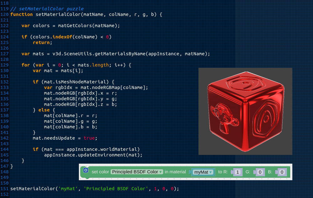

This is not a method but rather a tip. In fact, when you click the Save button in the Puzzles editor, it will generate a self-contained, human-readable JavaScript module saved as visual_logic.js file in your app folder.
This way you may have a working example of how certain JavaScript API methods work, and re-use the snippet generated for a puzzle of interest in your own code.
