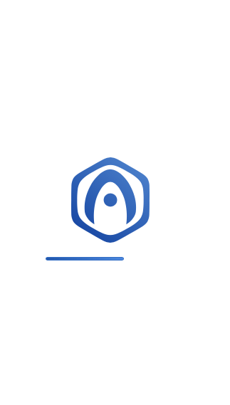

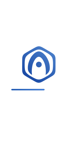

    #42943
    ilzh
    hello!
    did all as you wrote
    the app didn’t load (
    always in loading..
    printscreen’s attached
    2 printscreen – .gltf with replacement
    where is my mistake? what to do?

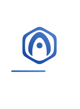

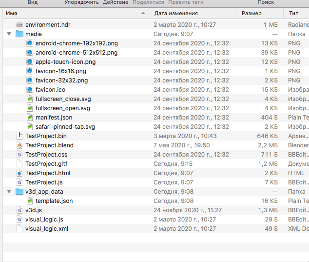

    #42947
    ilzh
    here are all my files of the project in it
    i replaced only .gltf here
    my app didn’t load (
    what to do?
    #42951

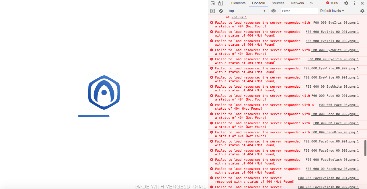

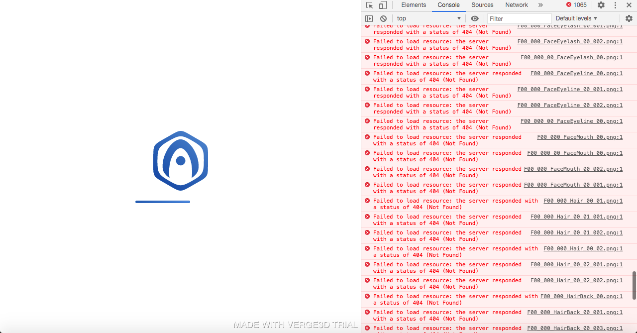

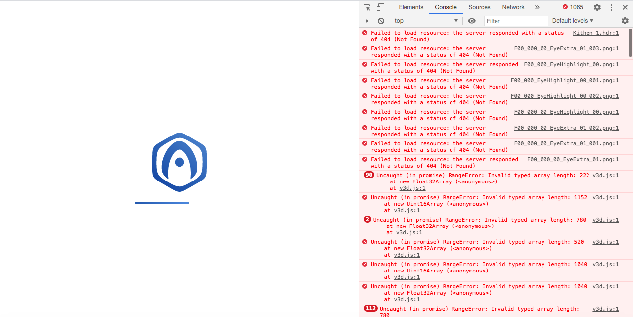

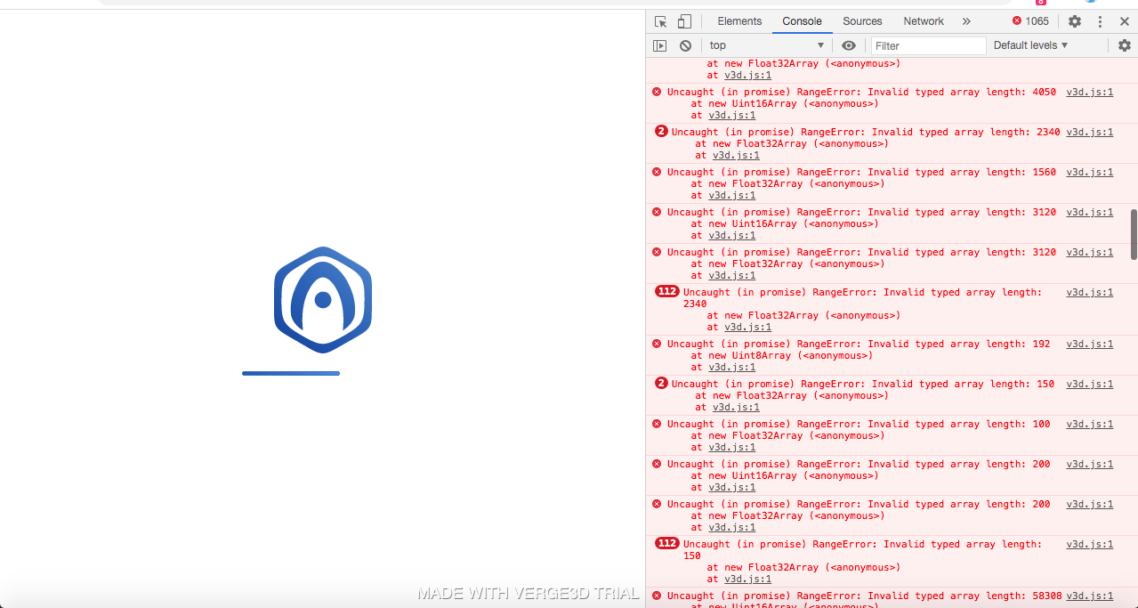

    I would use the Developer Tools in Chrome and watch the console to see what it is going on. You may have a timeout, a missing file, etc. I am sure that will give you a good direction to a fix.

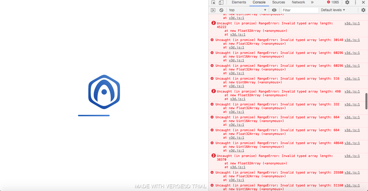

    #42952
    ilzh
    OMG %)
    i read your text
    and tryed to load “TestProject” in Chrome and open Chrome Console
    look what i saw in Console
    also usually i find all these files in my documents on HDD next day!!!
    what is it?

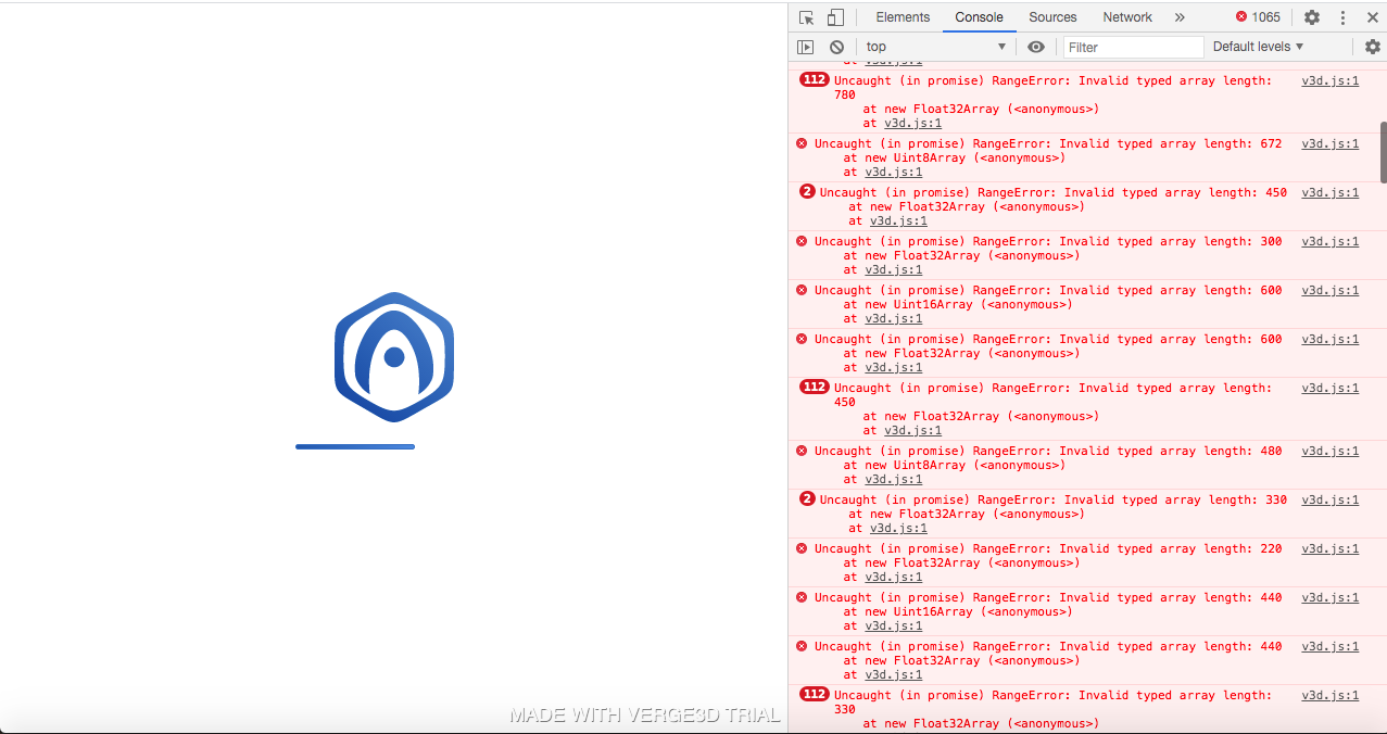

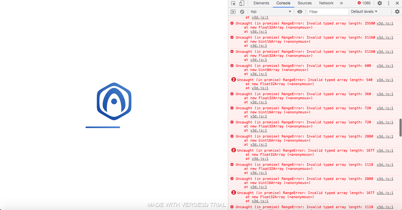

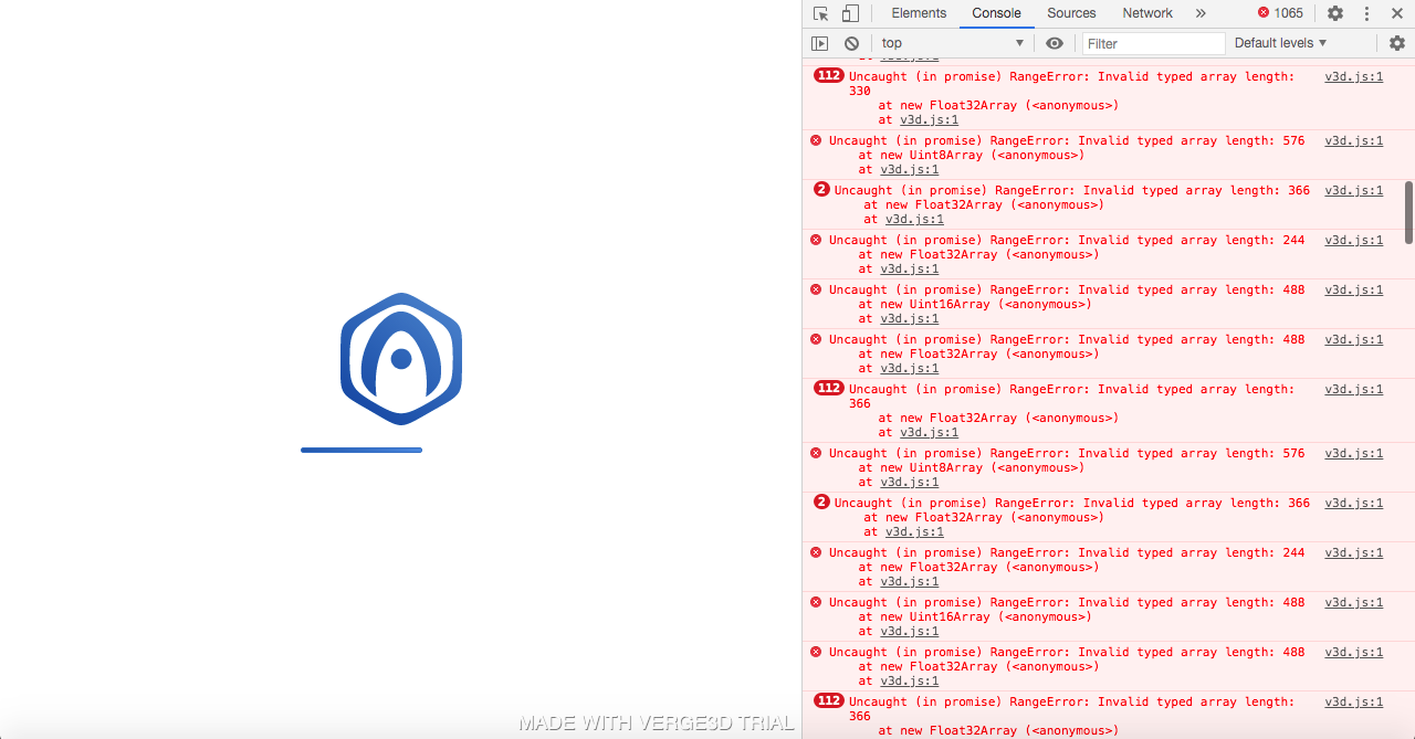

    #42957
    ilzh
    #42963
    ilzh
    i guess some files here are parts of my characters in the scene
    and something just is not correct
