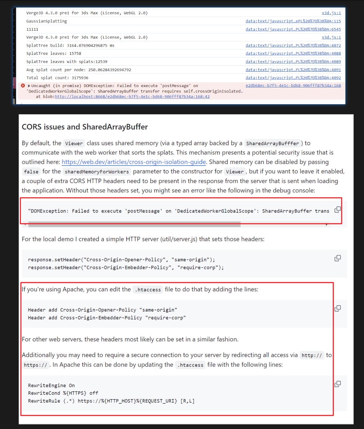

    @Yuri I’m try to test Gaussian Splatting in verger3D,how to solve this cross domain problem
    #69831
    aqiang
    Load success

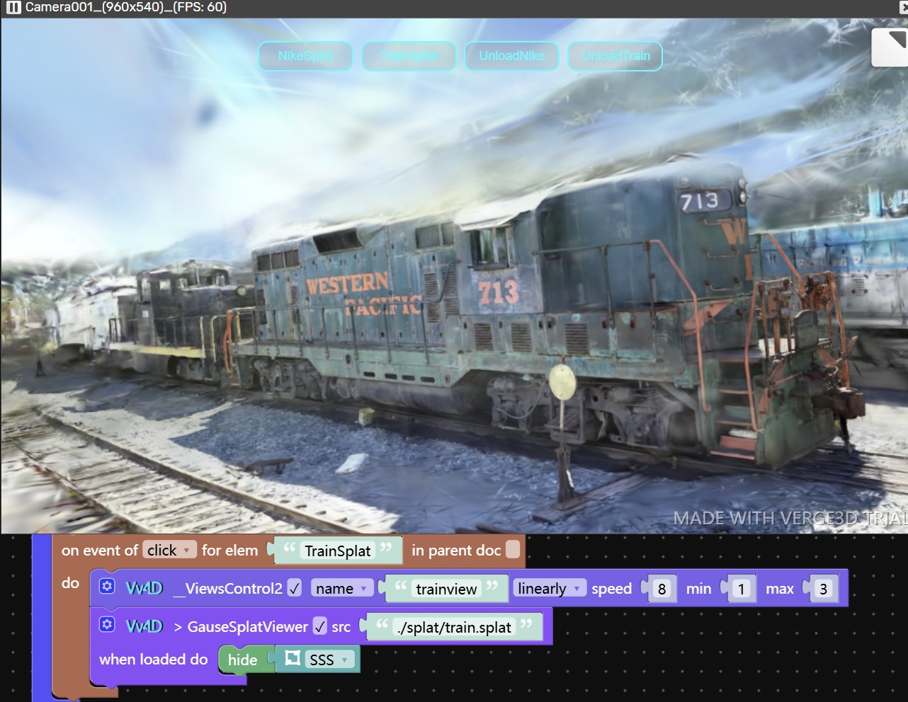

    I used to write a Gaussian loading plugin based on 3D Gaussian scattering, but the code was too long and the loading was slow. Later, I rewrote the plugin according to antimatter15 version, and the speed was good. I will send the demo case link later
    GauseSplatViewer
