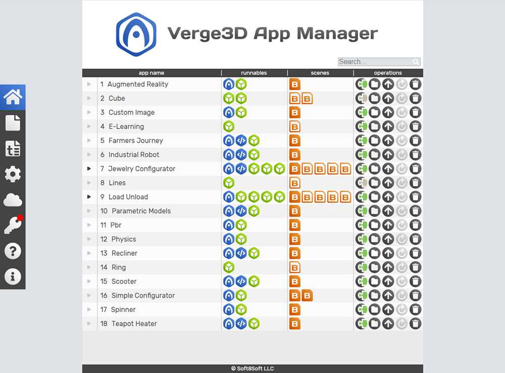

App Manager
Although you can start working on graphics first and create a Verge3D project later, we encourage you to get used to the App Manager from the beginning. By doing so you ensure that your files are properly organized and stored within the same folder which is important for the integrity of your project, especially if you plan to transfer it to a third party.
Another benefit of leveraging the App Manager beforehand is that you will always have a functioning web application which you can run/reload in the browser without the need to go to your scene files first.
App Manager main screen
The App Manager opens up in the web browser when you click the App Manager button. The default system browser will be running - you can change it in your OS settings. Any modern browser will work yet we recommend the latest version of Google Chrome which is fast, standards-compliant and offers good web development tools.

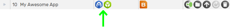

You can run your app any time by clicking the Verge3D icons, either the blue or the green one. The blue icon launches an app in its final form, with its Puzzles scenario and the programming code (if present). On the contrary, the green icon only opens the exported scene.
Buttons to run My Awesome App
A freshly created app loads and displays just a cube. You can look around with the left mouse button pressed, and zoom in and out with the mouse wheel.
Running My Awesome App in the browser

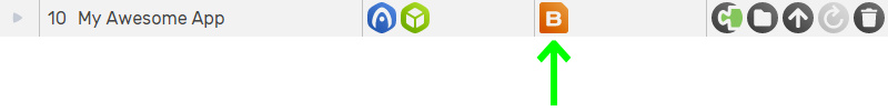

By clicking on the B icon you can open up the main .blend file of your application.
Button to open blend scene of My Awesome App

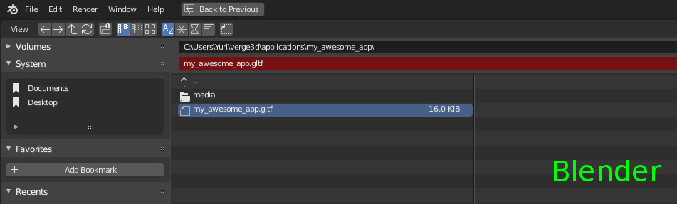

The save files can also be opened as usual via the FileOpen dialog or simply by double-clicking on them in the application folder. FileOpen may sometimes be more efficient since it does not spawn a new instance of Blender.
It is important to understand that an application only loads files exported in glTF format, rather than Blender's save files. So every time you change something in your source file, you must export from it in order to see the modified scene in your app.

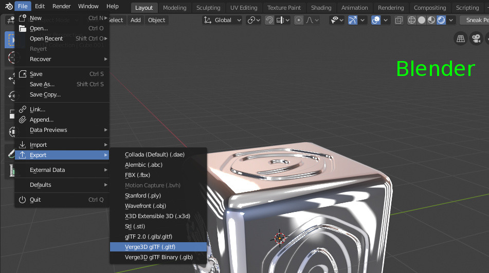

Exporting can be performed from the FileExport menu. You might want to assign a shortcut for this operation since you may perform it quite often.
Exporting Blender scene to glTF
Export your scene to the root of the corresponding application folder, in glTF format.
Selecting name for exported glTF asset

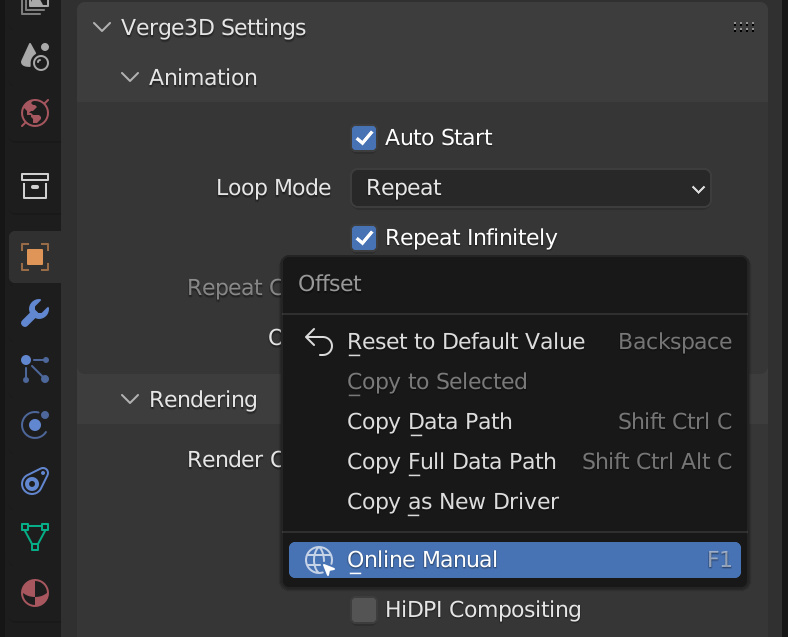

You can quickly obtain help on using any of Verge3D options or buttons through the right-click menu. You can also point to a feature and press F1.
Verge3D online manual in Blender

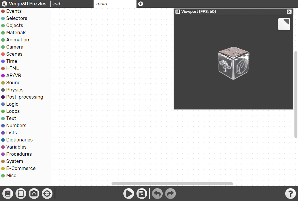

Click the Puzzles button near your app name in the App Manager. This will run your app with the Puzzles editor attached on top of it.
Puzzles editor screen

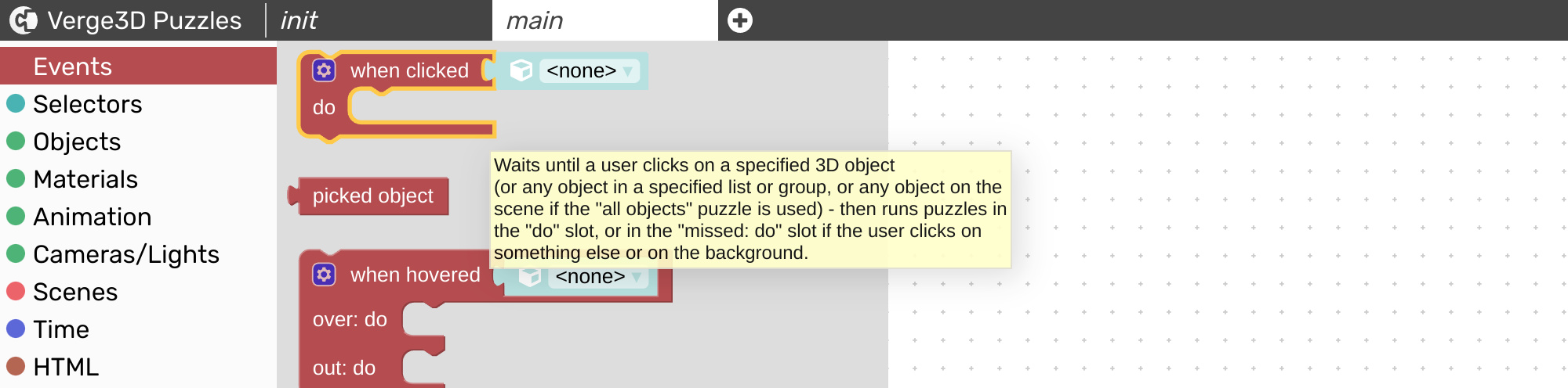

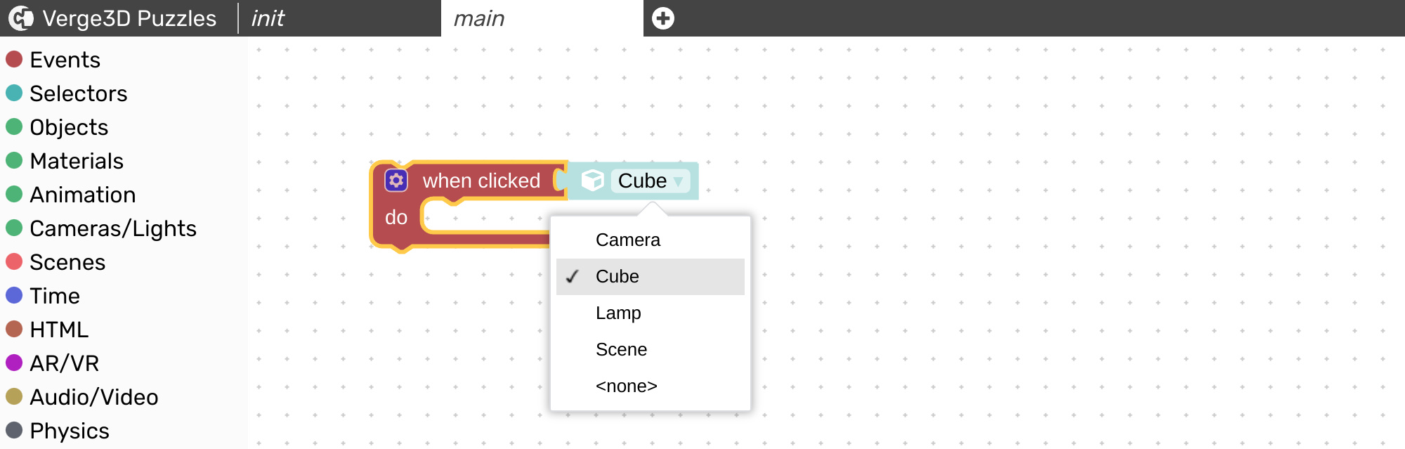

On the left the toolbox with some categories ("Events", "Selectors", "Objects", etc) is located. The categories are expanded upon mouse click revealing puzzles which you can drag out to the workspace. By connecting various puzzles with each other, you can create a scenario of how your 3D objects will behave upon user input.
You can quickly obtain help for any puzzle by hovering the mouse cursor over it or by using the right-click menu.
Puzzles toolbox

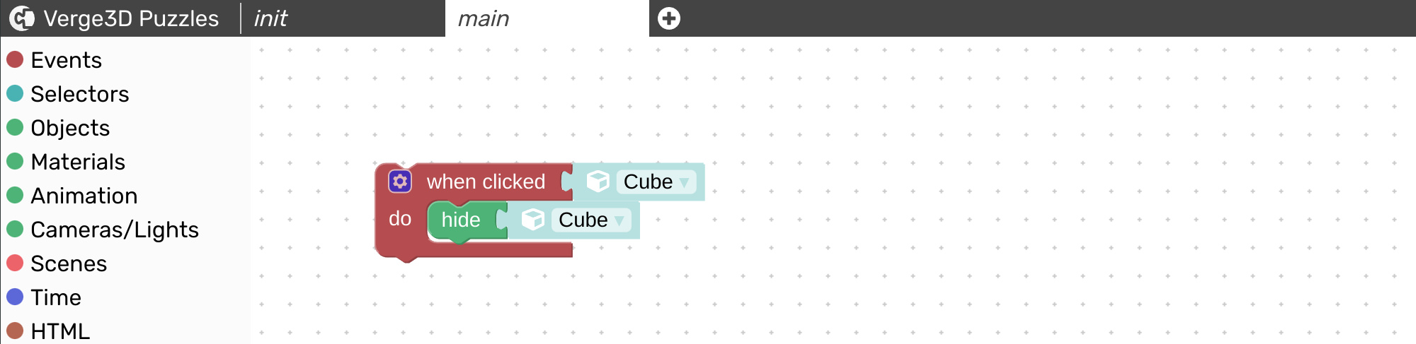

To do something meaningful for the beginning, drag out the when clicked puzzle from the Events category and select some object in the light-green dropdown.
Adding when clicked puzzle block from the toolbox
This puzzle causes your app to wait until the user clicks on the specified object, and then do... nothing unless you add something in the do slot.
Drag out the hide puzzle from the Objects and insert it to that slot. Select the same object ("Cube") in its dropdown.
when clicked and hide puzzle blocks in action
Now, once the user clicks on the 3D object, it should disappear. Click the Run button in order to launch your program and check if it works by clicking on the cube.

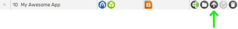

But what if you haven't had the chance to become a web master? No problem - by clicking a button in the App Manager you can upload your app to the Verge3D Network, a cloud-based storage and CDN hosted on Amazon servers.
Button to upload My Awesome App to Verge3D Network
After the uploading is complete, a screen will show up with a direct link which you can share by whatever means (in a blog post, social media, comments, email, you name it). It will also generate HTML code for embedding your app in third-party websites just like you do it with YouTube videos.

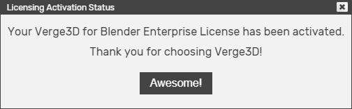

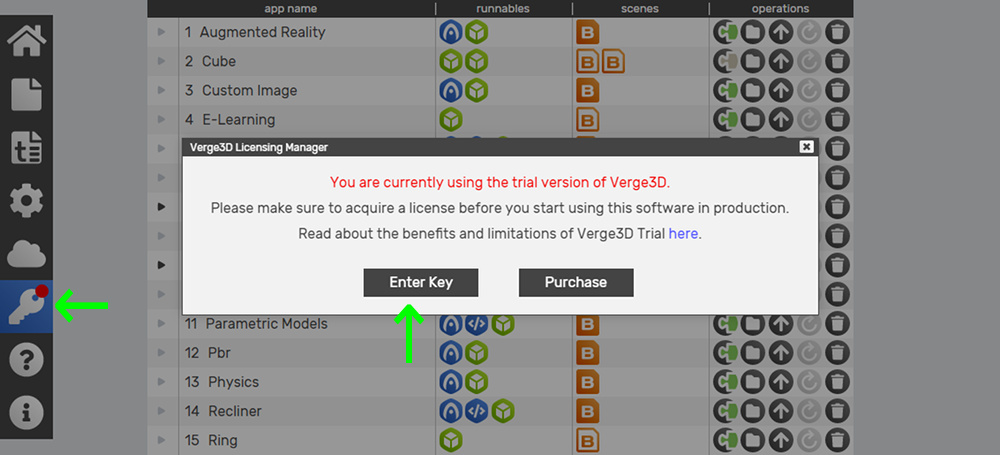

Activating License
You can take the trial for a spin for an indefinitely long period of time. However, for use in production you will need a license. The license information is sent via email (the key below is a random example).
E-mail with Verge3D license key Activating Verge3D for Blender license
The license key will activate your Verge3D instance and will remove the trial watermark from all your apps.
License activation status dialog
