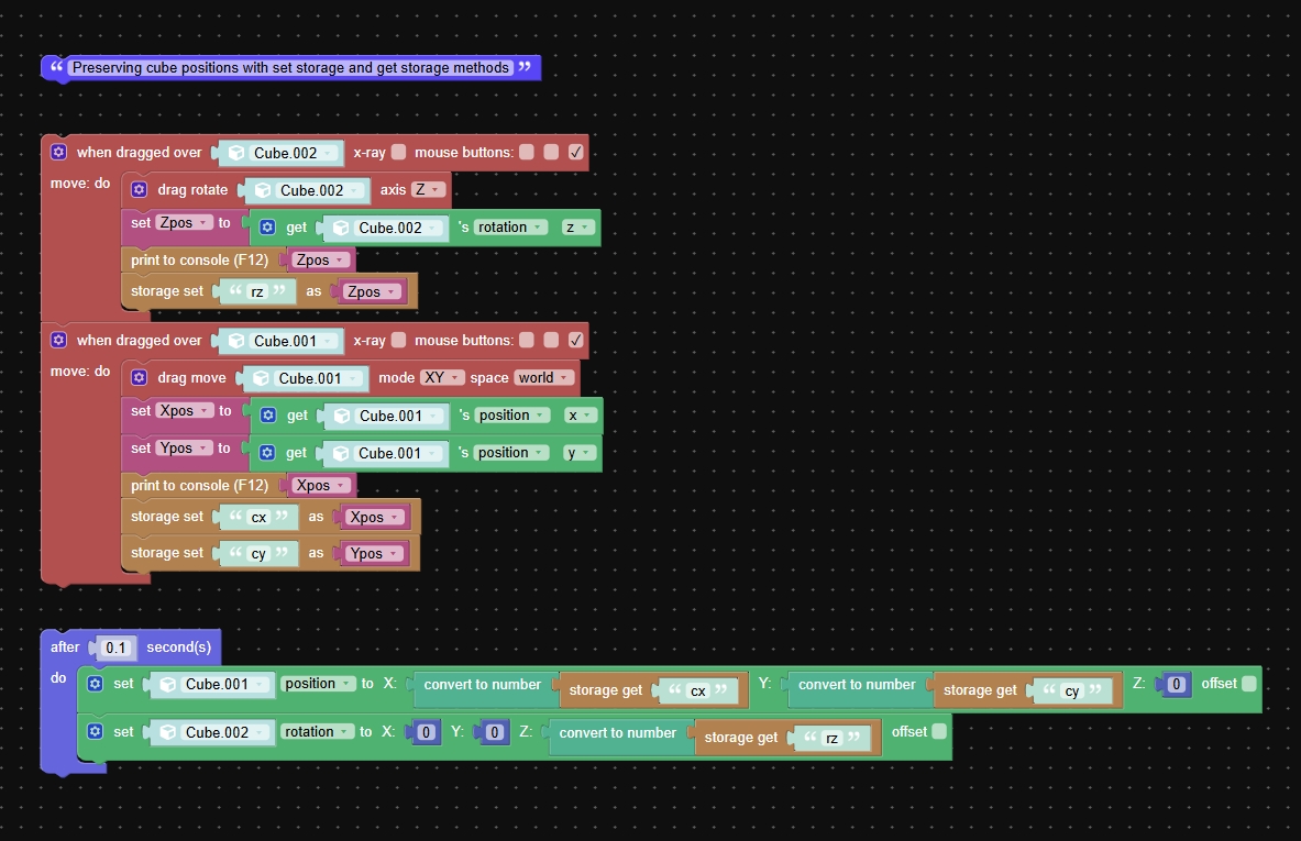

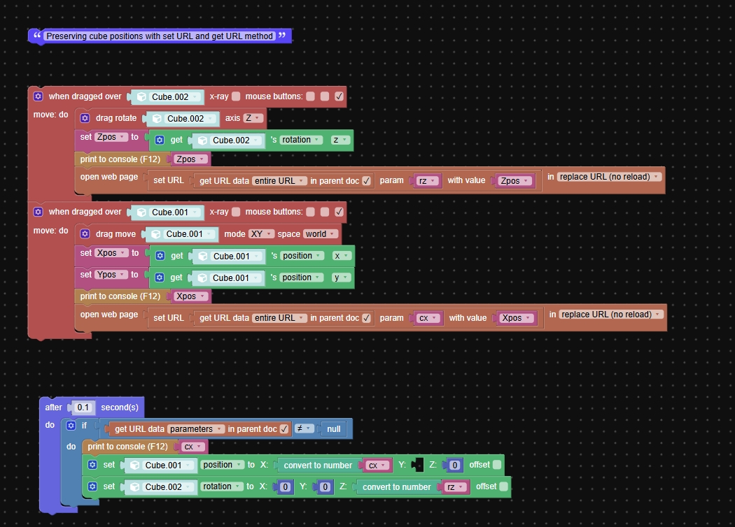

ParticipantI tried to implement puzzles with set URL and get URL method as well as set storage and get storage, but it is not working, what could be the issue?
2026-04-01 at 3:22 pm #86830
Alexander KovelenovStaffI tried to implement puzzles with set URL and get URL method as well as set storage and get storage, but it is not working, what could be the issue?
For URL params there should be key-value pairs where key is the name of the value to store. Once you get “parameters” you should extract individual keys with dict get key. Also, the 0.1s timer appears to be useless. You should extract parameters explicitly, e.g. during the app load or by pressing to some button, etc.
For the storage set/get example you should explicitly define what you store and what you extract. Again, timer appears to be useless.
In any case try to debug your snippet.
2026-04-04 at 7:12 am #86862saurav
ParticipantThank you for guidance. It worked fine now!

ParticipantThe scene works fine as long as the tab is open but when we close the tab and reopen the file, the original positions get reset. What shall be done to save the change permanently?
Do we have to create an external file where the data will be saved and read from?2026-04-04 at 2:47 pm #86868
Alexander KovelenovStaffThe scene works fine as long as the tab is open but when we close the tab and reopen the file, the original positions get reset. What shall be done to save the change permanently?
If it’s about saving data in the URL, you should specify full path, not just HTML to make the app work.
