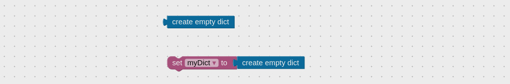

create empty dict
Returns a dictionary which contains no items.
Create empty dictionary in visual programming editor
Internally in JavaScript, an empty dictionary is represented by an object without any properties, that is { }.

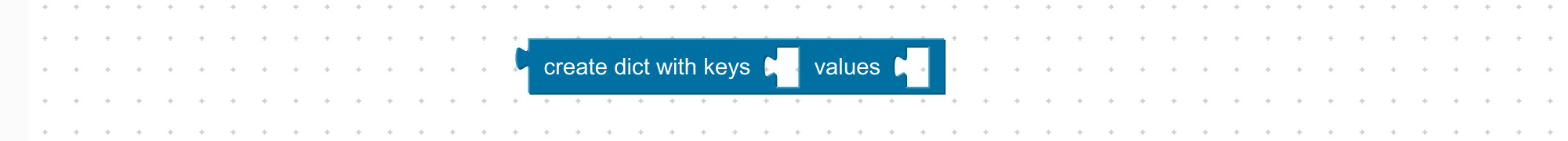

create dict with
Returns a dictionary with given keys and values.
Block to create dictionary with given key-value pairs

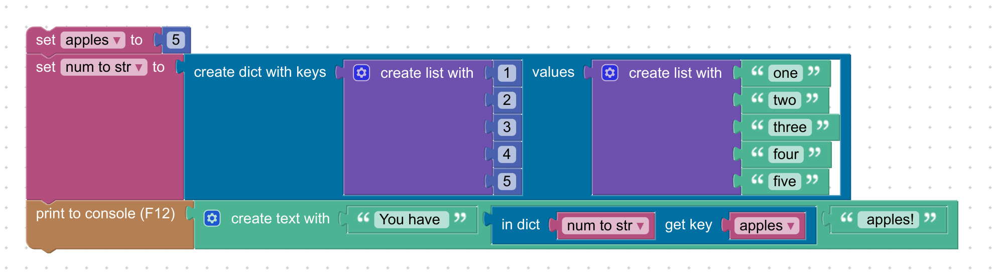

Keys/values can be lists:
Dictionary keys and values as lists

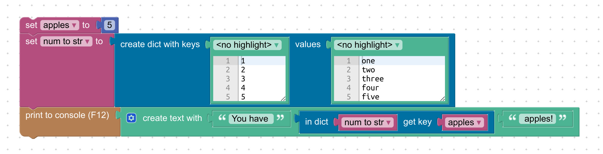

or multi-line texts, where each line represents a key or value:
Dictionary keys and values as text strings

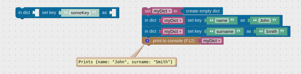

dict set key
Sets the item to be associated with a specified key in a dictionary. The key must be a text, while the assigned value may be of any type (text, number, list, other dictionary, etc).
Puzzle to set dictionary key

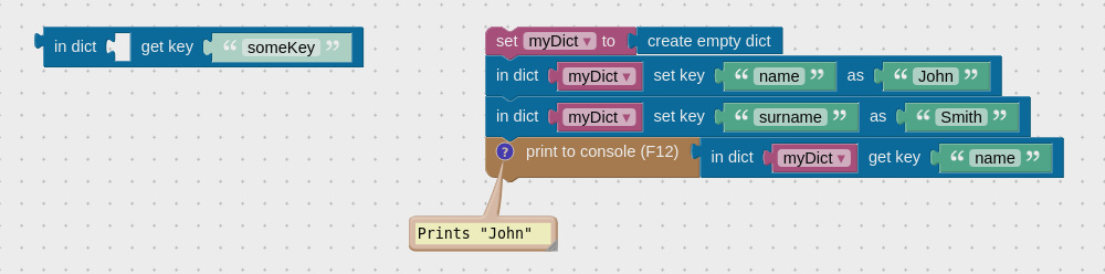

dict get key
Returns the item associated with a specified key in a dictionary.
Puzzle to retrieve values from dictionaries
If there is no item associated with the specified key, the puzzle returns undefined.

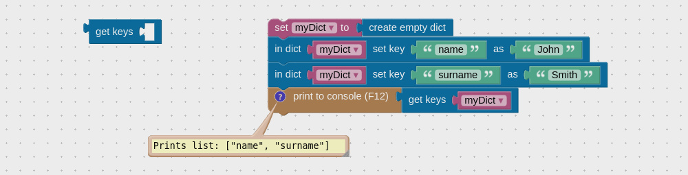

get keys
Returns a list of all keys present in a dictionary.
Puzzle to retrieve all keys from dictionary

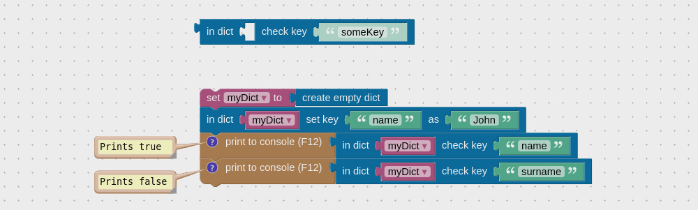

dict check key
Checks if a specified key is present in a dictionary, and returns the Boolean-typed result true or false.
Checking dictionary key with visual programming

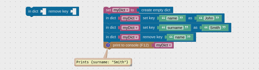

dict remove key
Removes the value associated with a specified key in a dictionary, and deletes the key itself.
Block to remove dictionary key

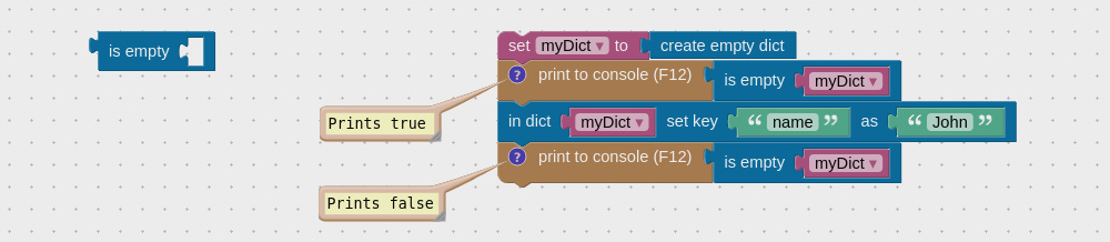

is empty
Checks if a specified dictionary contains no keys, and returns the Boolean-typed result true or false.
Puzzle to check if dictionary is empty
