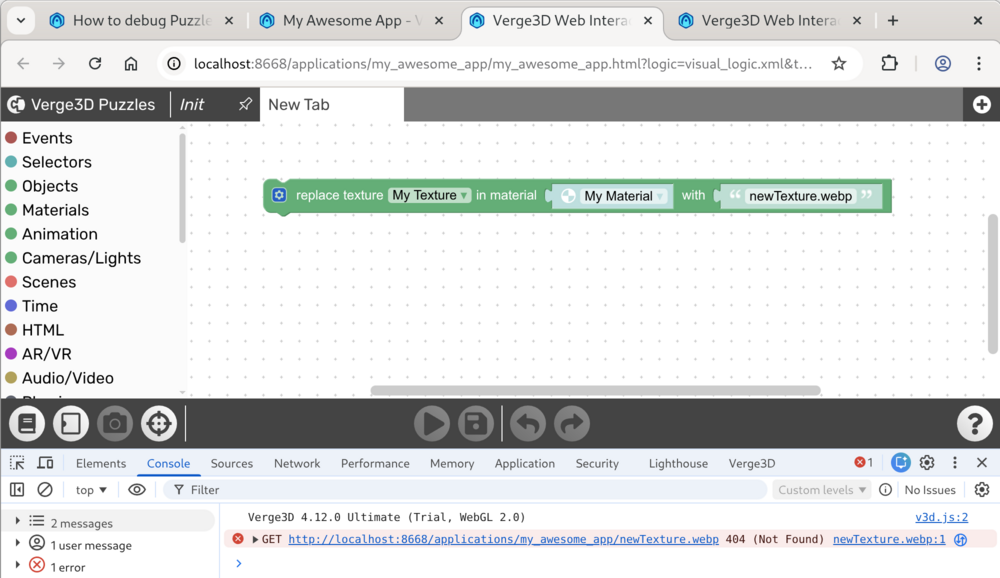

Check out the following example that explains the idea. Consider you need to replace a texture on some of your models with the replace texture puzzle, but nothing happens once you run this puzzle.
Don't worry! By looking in the browser console you'll find the cause of this issue immediately:
It says you've specified an invalid path to the texture! Fix the path and reload the app to see that the issue has gone.

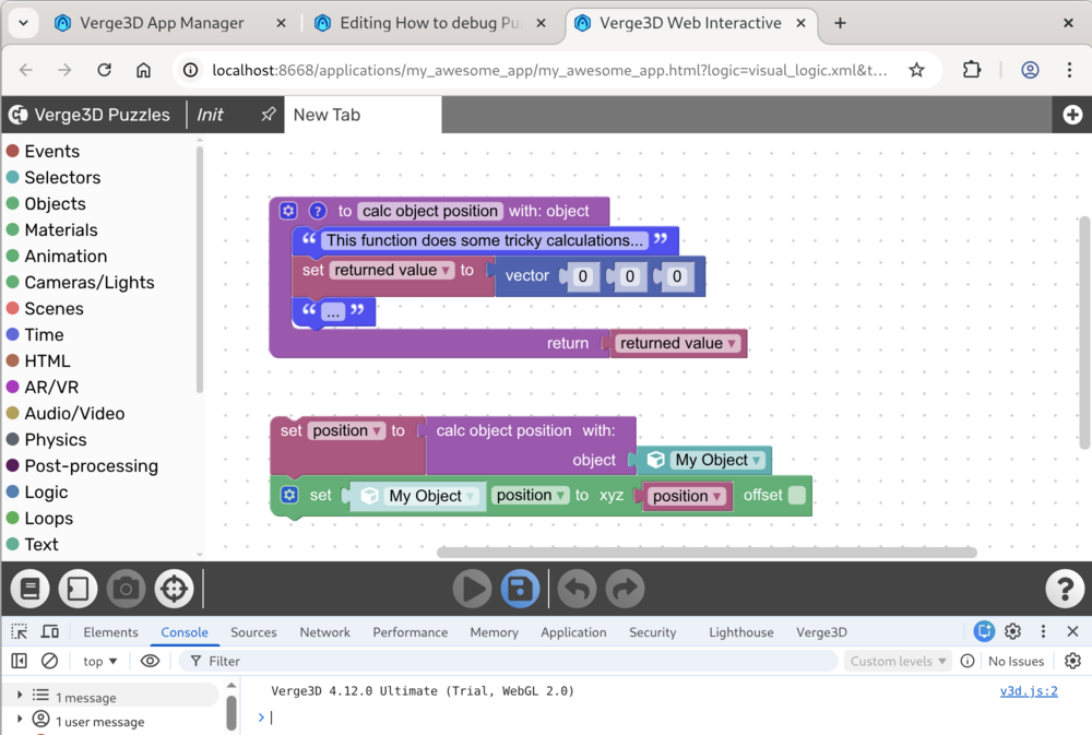

Let's explain it with the following example. Consider you need to calculate a position with some function ("calc object position") and then place some object to this position with the set transform puzzle. Once you've done with your scenario, you see that the object is not placed correctly. What should you do first? As you can guess, you should open the browser console!
Unfortunately, there are no errors printed there:
This means you should switch to plan B and insert the print to console puzzle into your scenario. But where to? Your internal voice may suggest that you should place it just before the actual object positioning takes place and just print the coordinates variable to see they are correct.

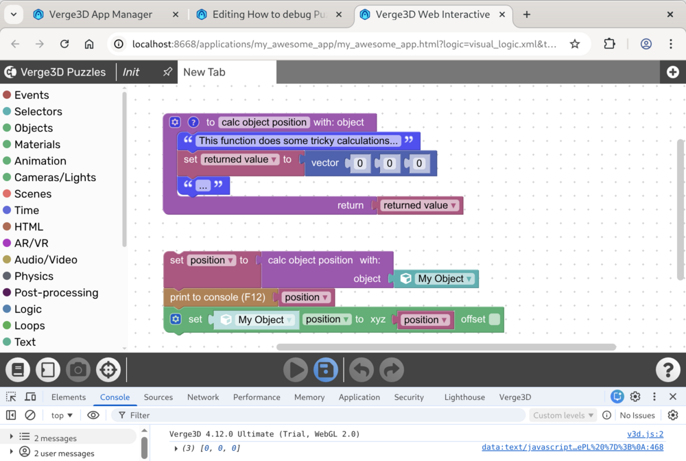

Here we go:
By running this code we finally see that the position returned by the "calc object position" is not correct. In our specific case it has zero values for all 3 coordinates (XYZ). Now it's time to review the "calc object position" and check for possible errors happening in that function. If necessary, insert as many "print to console" puzzle as needed to find the cause of the issue.
Printing to console is considered the most straightforward and efficient method of debugging. It's also very helpful for understanding what your script is actually doing. Again, don't hesitate to add as many "print to console" as possible. Print everything! Variables, function return values, values returned by the "get..." puzzles. Even plain "Here I am" string might be of some value.
