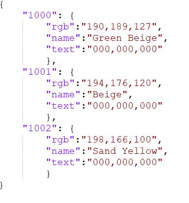

    Hello,
    can someone please tell me how to read Values from a Json file ond save the values in variables?
    I have a json file like on the first picture and i want to import the values into my project and save the values into variables.
    Can someone please tell me the correct way?

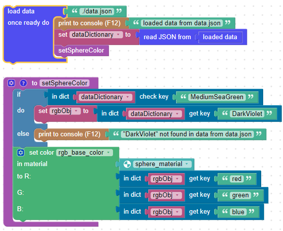

    Hi Jokob,
    I have to do this on every project, so I will share the technique I use. Use the puzzles that Yuri pointed out, but here are a few tips.
    1. The “load data” puzzle is asynchronous. Don’t assume your data is loaded on the first frame. Use the “once ready do” slot to initiate whatever actions you need to perform.
    2. Check if a key is in a dictionary before using it. See puzzle screenshot. Catch the error and do something if the key is missing. Typos and other data errors happen.
    3. The dictionary data type in the puzzle system is implemented as a JS object. So if your JSON has nested JS objects, you will need to use the dictionary puzzles to pick through the JSON. See color values in the puzzle screenshot.
    json puzzles
    sphere image

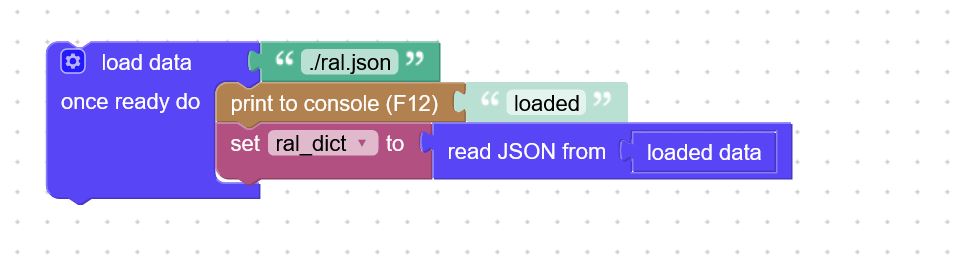

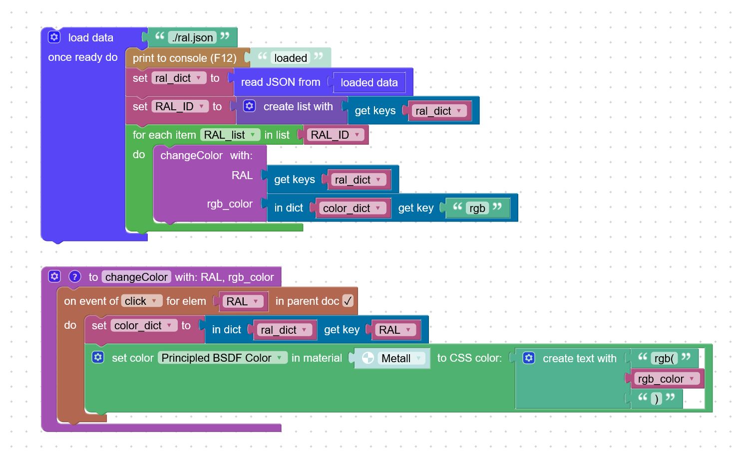

    Hello,
    Thanks for the information!
    Unfortunately I can’t get it to work as I needed.
    Even if I simply try to read the loaded data I get an error in the console “Read JSON Puzzle: could not interpret data.” I don’t get it as the JSON I think is the same as in the example of Jem, just with strings.
    JSON
    could not interpret data error
    I added my current puzzles in the attachment, pretty sure it would not work that way.
    Puzzle
    What I want to archive:
    I have a JSON-File where IDs and corresponding RGB-color values are stored.
    In my parent HTML UI document there are buttons with the IDs of the JSON.
    When one of those buttons is clicked, I want to have the color of one material changed to the corresponding RGB-color value.
    How to do that?
    Thank You!

    @fred7
    It may be that the file was not actually loaded for some reason. You can try to print to console the loaded data and see if your JSON is there.

    #58403
    Yes I’ve seen the files and they are ok. The thing is that as of version 4.1, the load data puzzle automatically reads JSON, so the other puzzle read JSON must not be used.

    #58415
    read any .gltf file (in fact, it has the JSON format). see the result. does it work with your set of puzzles?
    read this https://www.soft8soft.com/topic/verge3d-4-1-1-maintenance-update/#post-55477
