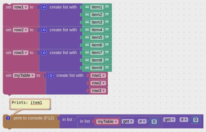

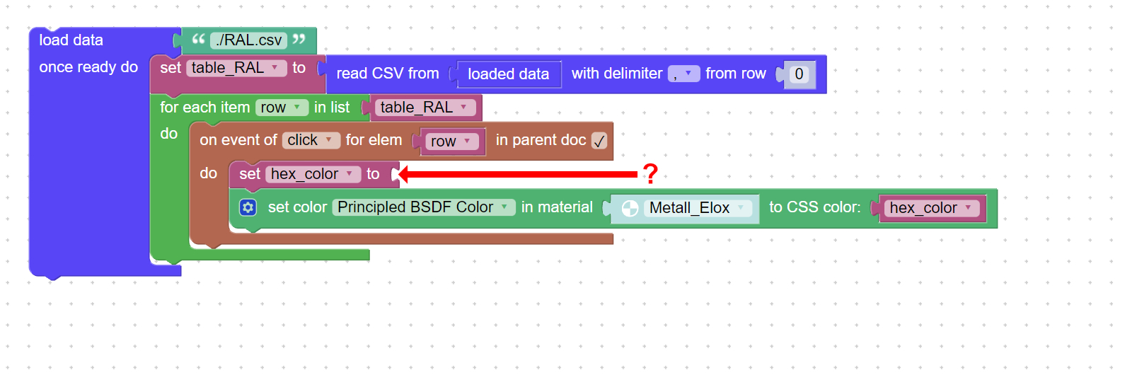

GLiFTeKCustomeri’ve loaded a csv into a list table.
i’m having difficulty specifying how to retrieve a specific block from it.
i want a variable to take the value of what is in the first column of the first row of my list.
any suggestions?Visit the GLIFTEK Verge3D Plugins Store!
plz share Discord link & on your signature!2019-09-06 at 6:38 am #18466
Yuri KovelenovStaffPlease take a look at this example: https://www.soft8soft.com/docs/manual/en/puzzles/Misc.html#read_CSV
2019-09-06 at 7:31 am #18468
GLiFTeKCustomerPlease take a look at this example: https://www.soft8soft.com/docs/manual/en/puzzles/Misc.html#read_CSV
right!
I’ve learned from.. and USE that example (modified for me) in my steps to retrieve certain row cells for certain queried row vars! :) successfully! it’s been great using this function.however.
I don’t know how to look for COLUMN 1, ROW 1’s cell. using the puzzles the way they are arranged.
i would think that i would do this:
but i can only say “#” not “item” …
list in list etc..
see image..Visit the GLIFTEK Verge3D Plugins Store!
plz share Discord link & on your signature!2019-09-06 at 8:03 am #18472

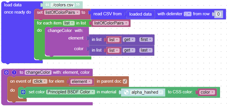

Yuri KovelenovStaffGot it! Here is an example of how you can get a cell from the first column, first row:

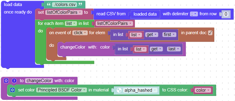

CustomerHello Yuri,

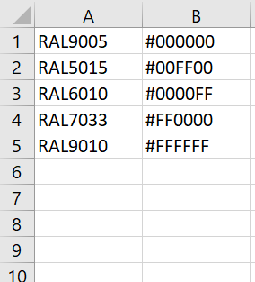

I need the same and unfortunetly I didn’t get it to work with your examples.What I wand to archieve:
I have a CSV-File where the first column stores RAL-colors and the second column is the corrsponding hex-color value.In my parent HTML UI document there are buttons with the IDs of the first column.
When one of those buttons is clicked, I want to have the color of one material changed to the correct hex-color value.
How to do that?
Thank You!

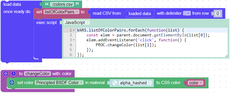

ParticipantLoops and global variables lead to really strange things in V3D )))
VARS.listOfColorPairs.forEach(function(list) { const elem = parent.document.getElementById(list[0]); elem.addEventListener('click', function() { PROC.changeColor(list[1]); }); });This MUST do the same, BUT it won’t work as expected )))
function changeColor(color) { setMaterialColor('alpha_hashed', 'Principled BSDF Color', 0, 0, 0, color); } loadFile('./colors.csv', function() { listOfColorPairs = readCSV(_pGlob.loadedFile, ';', 0); for (var list_index in listOfColorPairs) { list = listOfColorPairs[list_index]; eventHTMLElem('click', list[0], true, function(event) { changeColor(list.slice(-1)[0]); }); } });The problem is in the global variable
listthat must be local inside the loop. It must beconstorletto work properly…Puzzles and JS coding. Fast and expensive.

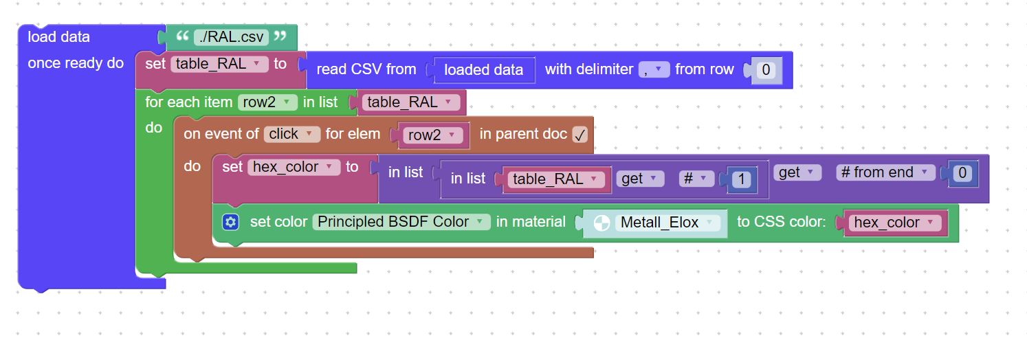

Ivan LyubovnikovStaffThanks for raising this issue! It affects the for_each and count_with puzzles. We will fix it in the next Verge3D release by making the corresponding variables local.
As for now to make it work you can apply the following workaround: https://www.soft8soft.com/topic/add-dragging-and-methods-to-a-list-of-objects/#post-26503
2022-09-01 at 10:58 am #55448kdv
Participantyou can apply the following workaround
Confirmed. The workaround is working
2022-09-01 at 12:05 pm #55462fred7
CustomerThank you very much! Works perfectly!

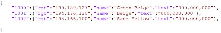

2022-11-23 at 9:36 am #58362fred7
Customeredit: Did also post the question into this thread, as it makes more sense there:
Hello,
this was working great, but unfortunately I need to switch to a JSON as loaded data. Can anyone help me out to have the same functionality just with a JSON? Would be amazing, as I am struggling to understand it. Please see the JSON attached. 1000, 1001, 1002,.. should be IDs in the parent doc and if one of the buttons is clicked, the corresponding RGB value should be used for the set color puzzle.Many thanks!
