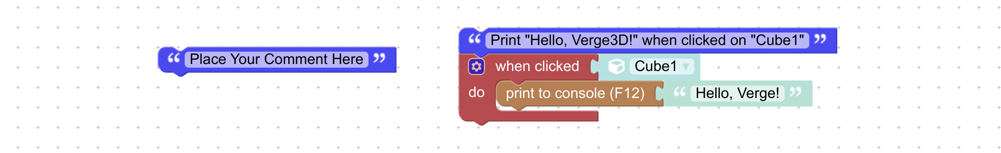

comment
This puzzle does nothing except places a comment line to make your script easier to grasp. It also adds a JavaScript comment line to visual_logic.js.

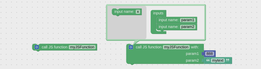

call external function
Executes a function specified in the JavaScript code of the application. Optionally passes parameters to be used as function arguments.
In order to add a function to JavaScript code, open the application .js file (for example, my_awesome_app.js located in the my_awesome_app folder in the applications folder) with any text editor. Search for prepareExternalInterface and add your function inside that declaration (between the curly brackets), so that it looks like this:
function prepareExternalInterface(app) {
app.ExternalInterface.myJSFunction = function(numericArg, textArg) {
alert('Got some params from Puzzles: ' + numericArg + ' and ' + textArg);

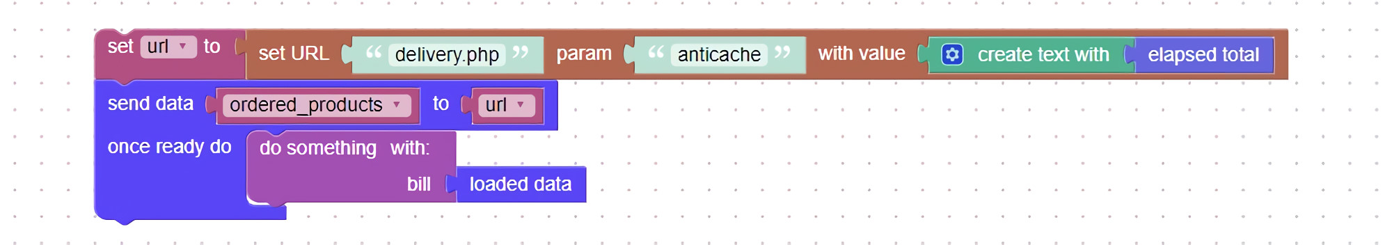

send data
Send a specified data to a remote location using an asynchronous POST HTTP request. The retrieved data can be accessed via the loaded data puzzle. JSON objects (both sent or received) are automatically converted to dictionaries, form data values are sent as is, while all other data types are sent/received as text values.
The enable "with headers " slot is used to provide additional request headers via the dictionary object. The enable "on error" slot setting is used to handle errors via additional on error do slot.
Keep in mind, that browsers might keep local copies of retrieved assets for optimization purposes. To avoid browser caching, an additional parameter can be used to change the URL each time you make a request. To add this parameter, use the set URL param and elapsed total puzzles:

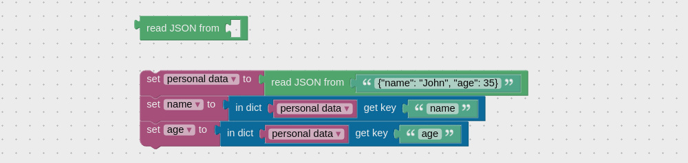

parse json
Interprets text (or Data URL) as JavaScript Object Notation data which is returned in a dictionary.
The puzzle does the reverse operation to stringify json:

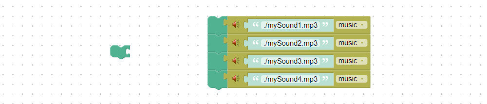

connector
This puzzle facilitates connecting other puzzles with each other, to make it more convenient to move, delete and use them in other puzzles. The most notable application is to join load sound or load video puzzles into a single group to organize preloading of media resources in your application.

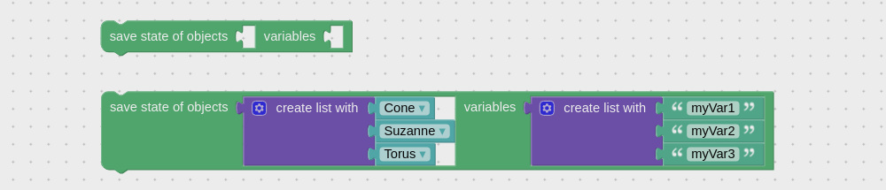

save state
Saves the state of specified objects and/or the values of variables specified by their names. The objects are cloned and stored in memory. The values of the variables are retrieved and stored in memory for each specified variable name.
If this puzzle is called several times, the states are saved in sequence so that it is possible to return to any previous state with the undo state puzzle.

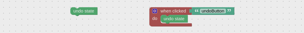

undo state
Restores the state of objects and/or variables saved with the save state puzzle.
If this puzzle is called several times, the states are restored from the saved sequence (if any) which makes it possible to return to any previously saved state from the stack. Sometimes you need to catch the situation when there is no saved state present in the undo history, e.g to make changes in the UI. For that, use the state counter variable:

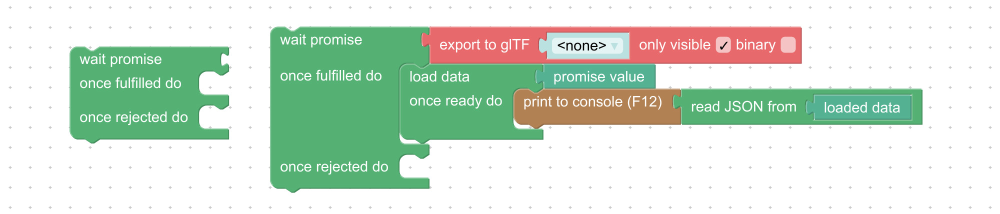

wait promise
Wait for the promise to be resolved or rejected and return its value (or rejection reason) in the promise value puzzle.
This puzzle may be required to get value of the export to gltf and generate normal map puzzles. Being async puzzles by their nature, these puzzle do not return resolved values immediately. Instead, they return promise values which are implicitly resolved in the puzzles they are used as inputs. In some rare cases, however, this resolving does not happen. In these cases you should use wait promise to resolve promise values.
promise value
Resolved promise value (in case of resolved promise) or error string (in case of rejected promise).

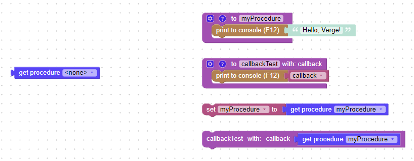

get procedure
This puzzle can be used to obtain a procedure defined in Puzzles. The returned value can be assigned to a variable or passed into another procedure as a parameter and then executed later via the call procedure puzzle.
call procedure
Executes Puzzles' procedure obtained through the get procedure puzzle. Optionally passes parameters to be used as procedure arguments. There are 2 variants of the "call procedure" puzzle — with and without a return value.

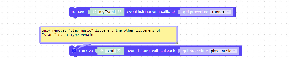

remove event listener
Removes listener from the specified event type, i.e. removes given procedure from the event type listener.

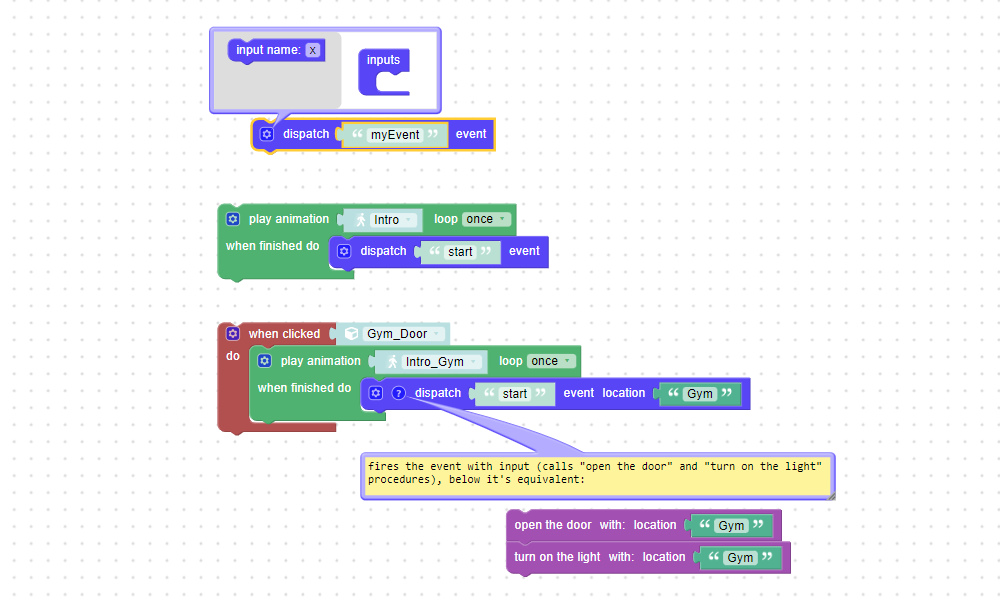

dispatch event
Trigger an event of the specified type. Optionally passes parameters to be used as procedure arguments (i.e. the same arguments for each procedure).
