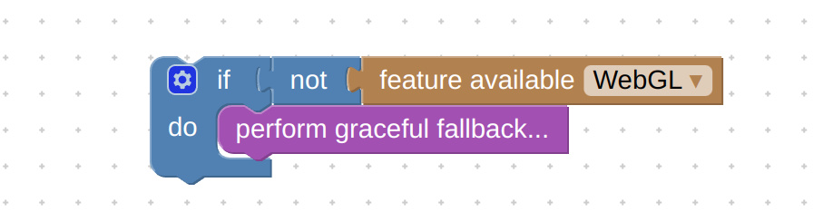

Besides the foregoing fixes, we managed to make puzzles in the Init tab to work even if the user browser does not support WebGL. This means that you can easily replace the 3D content by a video, image or custom HTML content on unsupported systems, thus allowing a graceful fallback. You can easily find out if such a procedure is needed, by checking against the WebGL option that we added to the feature available puzzle (for use in the Init tab).

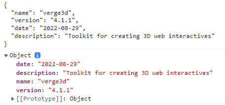

Hi, it’s kinda important for us to support older devices. Please provide more info so we can investigate this issue:
- Did you really updated your app (clicked on the update button)? To verify, open the browser console and see what Verge3D version it prints.

Customer- Did you really updated your app (clicked on the update button)? To verify, open the browser console and see what Verge3D version it prints.

1. Yeah, I had some troubles with that, but you helped me to fix it in another topic on this forum. So now it’s fully updated.
