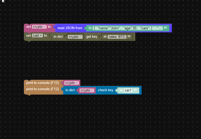

can someone please tell me how to read Values from a Json file ond save the values in variables?
I have a json file like on the first picture and i want to import the values into my project and save the values into variables.
Can someone please tell me the correct way?
thank you!

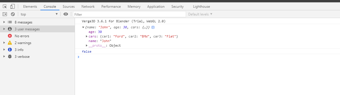

ParticipantHi Yuri,
How can I read a subset of json listed? See the picture. I get false when I check the Ford string.
For example the value of car1?
“name”:”John”,
“age”:30,
“cars”: {
“car1″:”Ford”,
“car2″:”BMW”,
“car3″:”Fiat”
}Thank you!

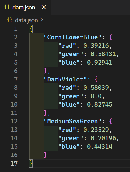

What I want to archive:
I have a JSON-File where IDs and corresponding RGB-color values are stored.In my parent HTML UI document there are buttons with the IDs of the JSON.
When one of those buttons is clicked, I want to have the color of one material changed to the corresponding RGB-color value.
How to do that?
Thank You!

2022-11-24 at 4:53 pm #58415kdv
Participantread any .gltf file (in fact, it has the JSON format). see the result. does it work with your set of puzzles?
read this https://www.soft8soft.com/topic/verge3d-4-1-1-maintenance-update/#post-55477

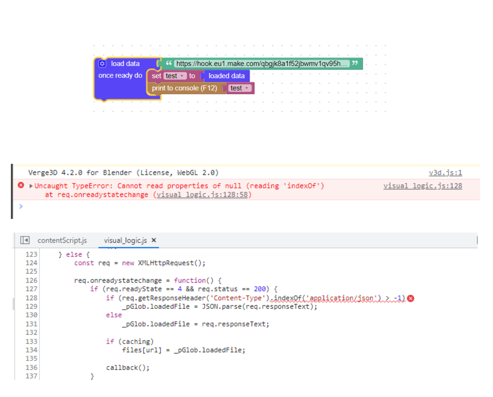

CustomerHello,
I have the problem that after the update to 4.2 my puzzle logic for importing and reading a json-file via a rest API does not work anymore.
The solution described above that you no longer need a “read json” puzzle I have already adapted.
It all works when I load a local jason-file, but as soon as I want to load the json-file via a REST_API I get an error message (see photo). I think it has something to do with the response of the server.
Would be very happy if someone has a solution.Link to the REST API with the json file:
https://hook.eu1.make.com/qbgjk8a1f52jbwmv1qv95hz126c8j9dyThanks a lot and best regards
