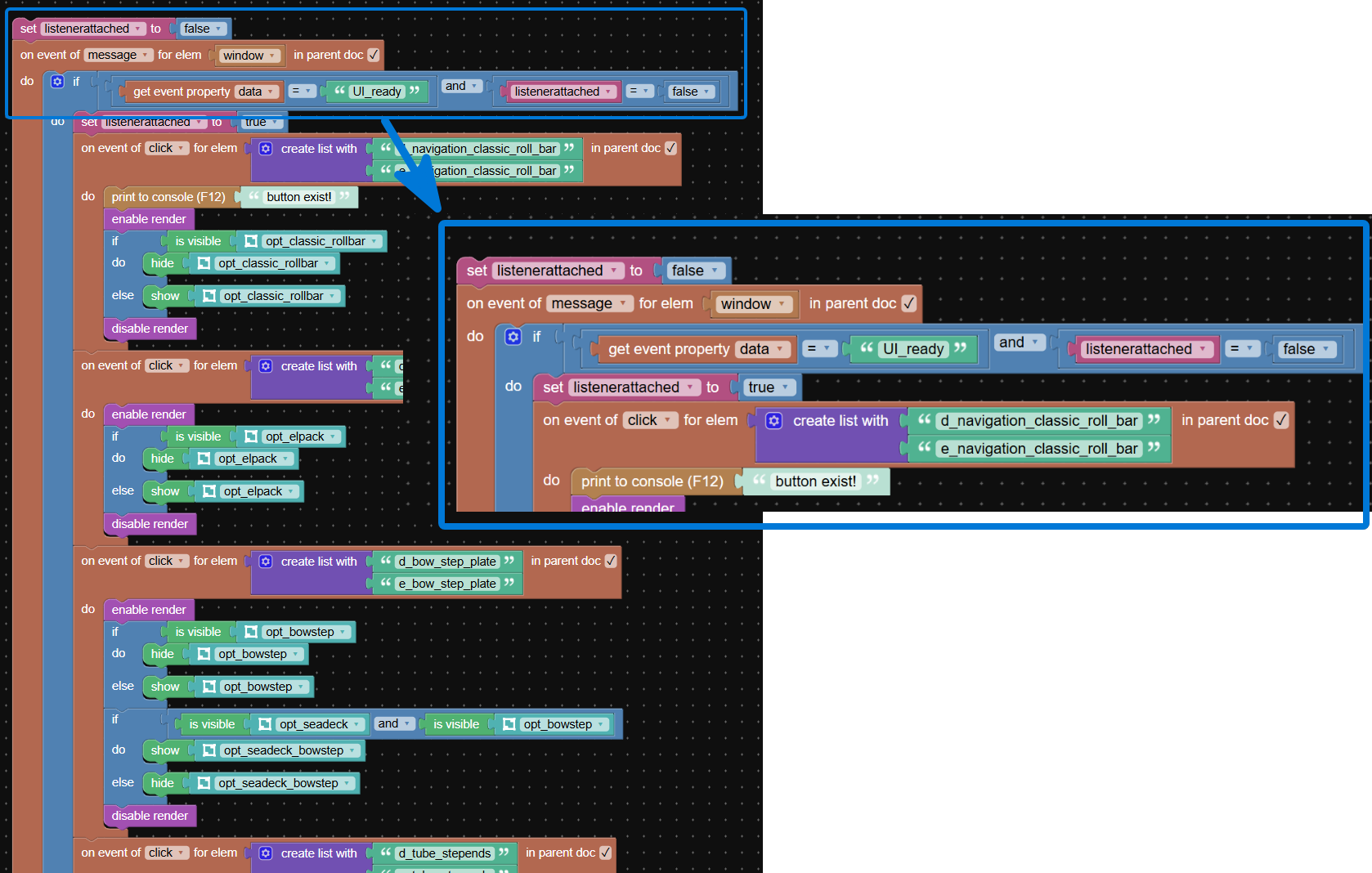

    Delaying Verge3D page startup might not be the most efficient method to fix this issue. Instead you can try running the verge app normally, but send a message (with postMessage) to the iframe once the buttons are ready. In puzzles you can catch this message by using the on event of puzzle and attach all required event listeners in the do slot of this puzzle.

    I attached a screenshot of how I understood it. Is this structure correct? And if yes, does it mean I need to move all ~100+ click event puzzles there inside that do slot Or turn all of this in procedure to make list shorter?

    When you load the main frame first, and iframed Verge3D app second, there is some time lost. By utilizing postMessage you can load both in parallel and delay registering event listeners then the elements will actually be available.
    Your snippet looks OK. If there are any issues, try to debug with print to console puzzle.
