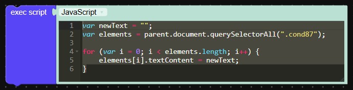

    I created my first configurator for a client. It’s amazing how easy this is with Verge3D.
    However, I have an “exec script” with the following javascript:
    var newText = “”;
    var elements = parent.document.querySelectorAll(“.cond87”);
    for (var i = 0; i < elements.length; i++) {
    elements.textContent = newText;
    Just out of curiosity, can this be recreated using puzzle blocks?
    #86222
    Unfortunately, querySelectorAll is not yet supported in Puzzles, just querySelector. However this task is in our TODO list, so we’re going to support this feature eventually.

    #86229
    Great, feel free to share!
    P.S. querySelectorAll feature has been revised and got higher priority. Expect it in the upcoming Verge3D update :yes:
