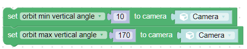

2024-11-18 at 9:50 am #78891kdv
Participantset a couple of limitations to prevent this issue
