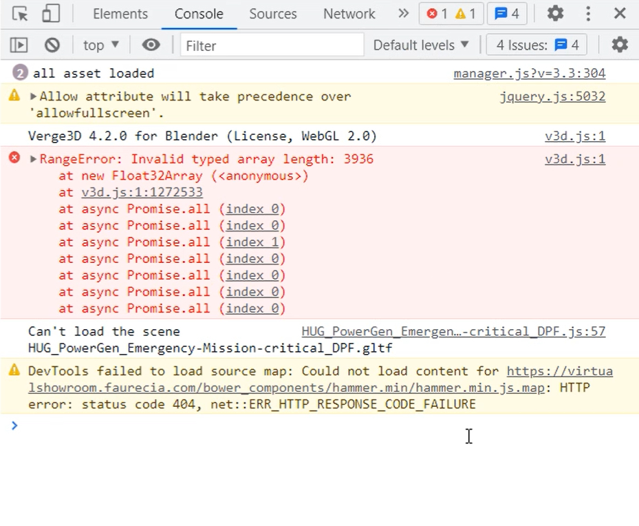

    Hello support,
    My client have some errors loading the 3D products I have prepared for them. The loading stop at 60%.
    attached is the console errors.
    All the old products (made with the 3.7 version) are loading perfectly.
    The ones made with the 3.9.7 or updated with the 4.2 are not loading with these errors.
    These products load perfectly on my computer, and on some other computer.
    Please help !
    Laurent.

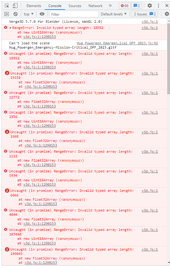

    I have downloaded an old 3.7 version, I’m going to test to re-export with this version to see if the problem continue…
    #60927

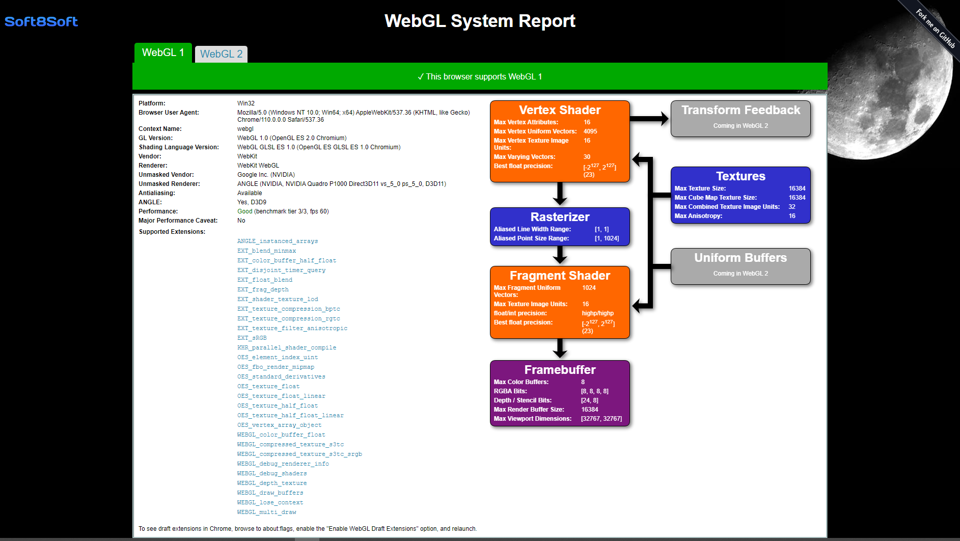

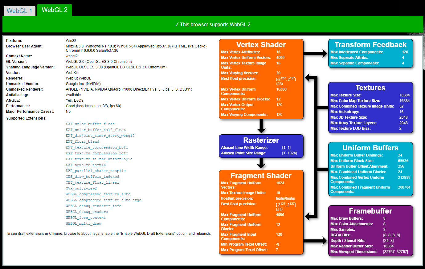

    Hello Yuri,
    The problem continue even with the file completely re-made in an old blender 3.9.7 and verge 3.7…….
    included some screenshot and the reports from https://www.soft8soft.com/webglreport/
    and chrome://gpu/
    I can send you the link to the product in private if needed.
