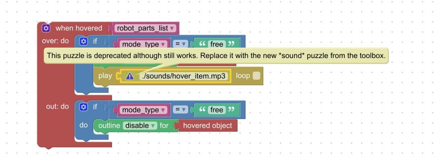

Removal of deprecated puzzles
Deprecated puzzles are now removed and replaced by dummy blocks. Be sure to update your project Puzzles before migrating to Verge3D 4.0.

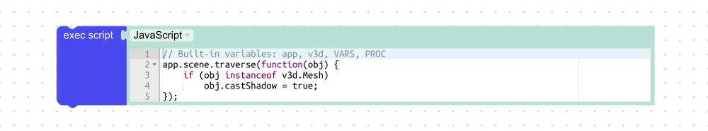

For example, to turn on shadows from all meshes in your scene, you can use the following script:

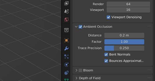

Removed deprecated Puzzles-based AO
Instead of the AO puzzle removed in Verge3D 4.0, use GTAO-based ambient occlusion enabled in the modelling suite:
