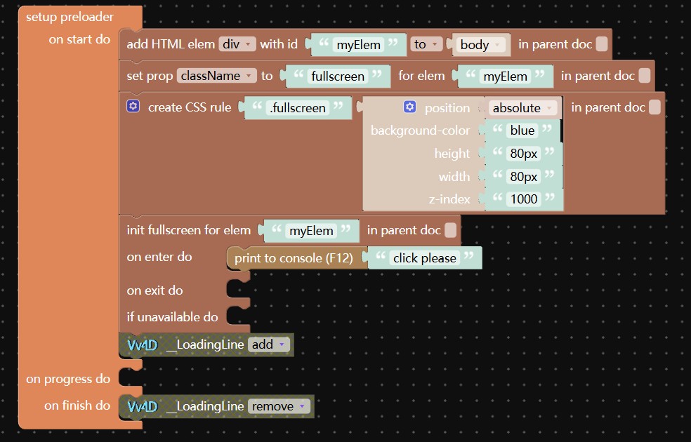

    #83565
    c4cc
    Sorry for the stupid question, but what is Vv4D here?

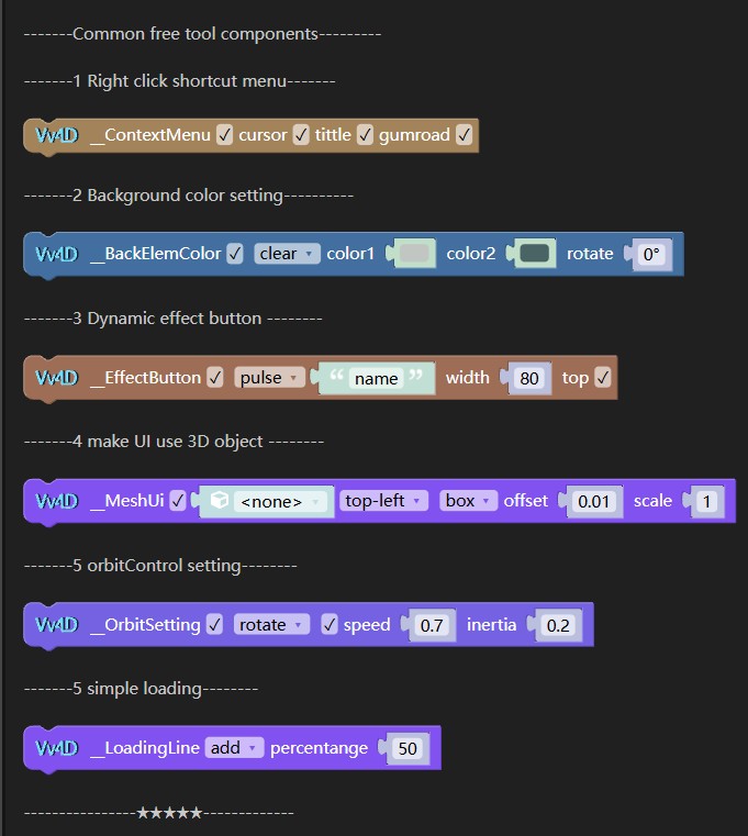

    #83566
    QiangGe
    Since we used the preloader puzzle, the default loading progress bar is no longer available.
    So I added the simplest progress bar plugin puzzle. In the current example, this puzzle is already disabled, so you can consider it as if it’s not there—it won’t affect loading.
    Perhaps you haven’t used plugin puzzles before, so I’ve shared a set of free puzzle installation packages that include this puzzle. You can download and use them freely.
    For installation instructions, you can check the documentation page and search for “Example Plugin.”

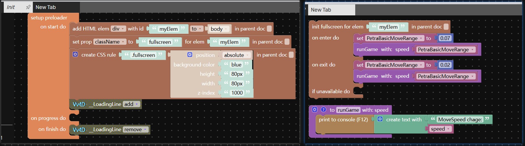

    c4cc
    sorry, I tried this but it didn’t work
    Init tab
    Other tabs
    #83693
    QiangGe
    The key is that you modified the variable, but I didn’t see you calling it,
    The update can be triggered only when it is called. You can call it in the full screen event or in the animation cycle
