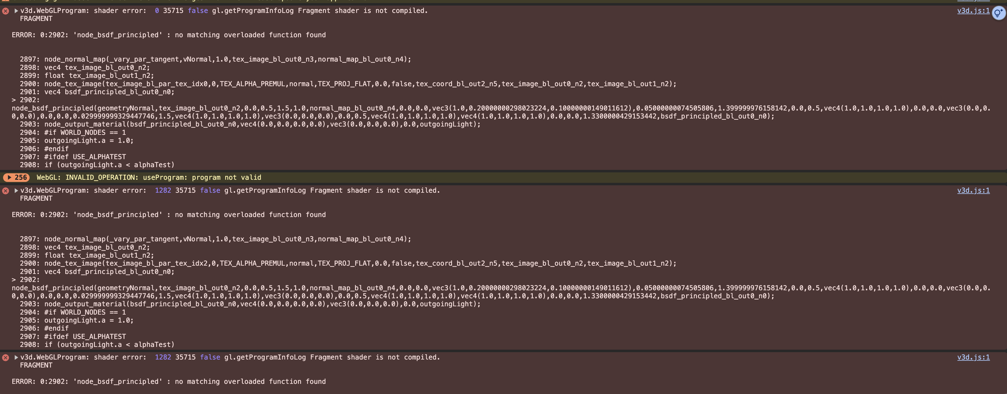

    Hi there, could you help me please? I am trying to visualize a mesh in Verge but it gives me an error, how can I fix it? :scratch:
    #81980
    Ignacio Díaz
    I am using blender 4.4.3 and verge 4.8.0 (that’s the last version I could download with my licence). Should that be the problem? I tried with the diffuse BSDF and it worked but I notice also that it’s not playing the animation (shape key animation)

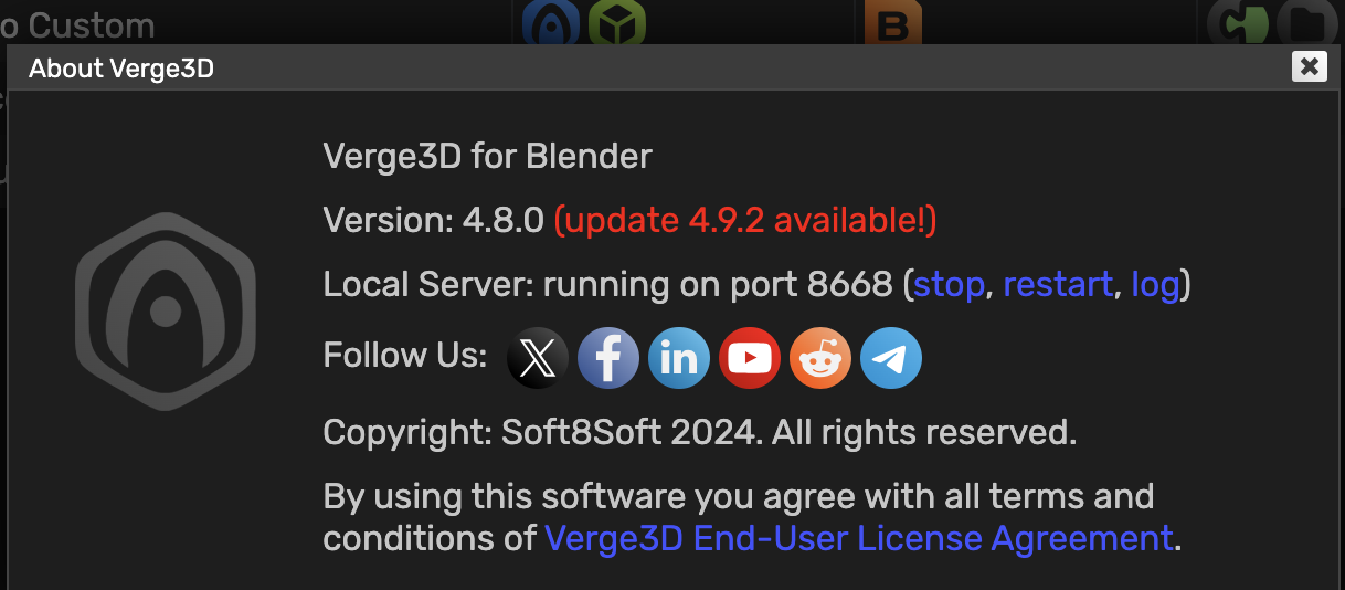

    Ignacio Díaz
    I installed the 4.8.0 version of Verge3D but when I click sneek peek in the browser console says it`s the version 4.7.
    #81996
    Ignacio Díaz
    In the app manager it says 4.8. I am using a intel mac by the way

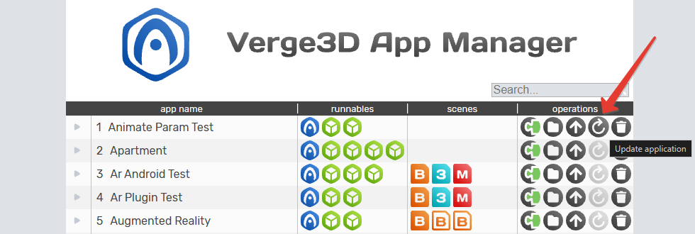

    #81999
    you didn’t update the app itself…

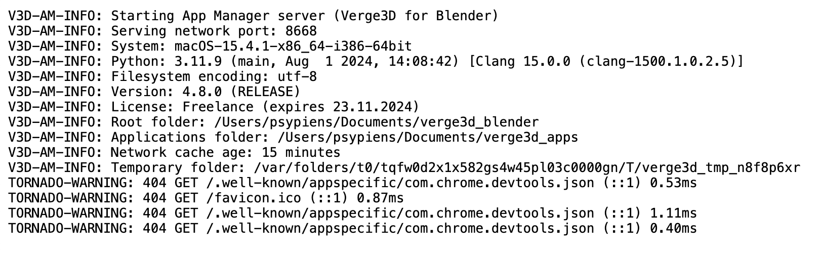

    So when you create a new application it shows 4.7.1 in the console? While in the about dialog you see 4.8.0? Try to reload your PC and install Verge3D a new. If the issue persists, please send use the content of this page: http://localhost:8668/log
    #82050
    Ignacio Díaz
    Yes, in the app menu it shows 4.8 and in the browser console, 4.7. Here is the log.
    #82060

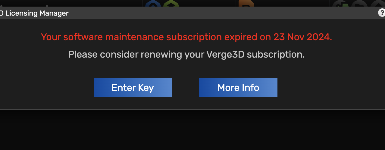

    Looks like you have an expired version of Verge3D so the engine prevents the app switching back to trial. You might want to renew your license subscription or revert back to 4.7.0.
    #82061

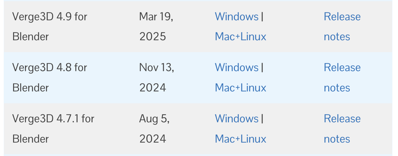

    Ignacio Díaz
    It should be possible for me to use version 4.8 because my licence expired in november 23 and version 4.8 was realesed in november 13, that might be an error from your licencing system. :/
    #82064
    You might need to enter the license key a new in that case.
