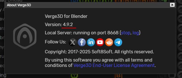

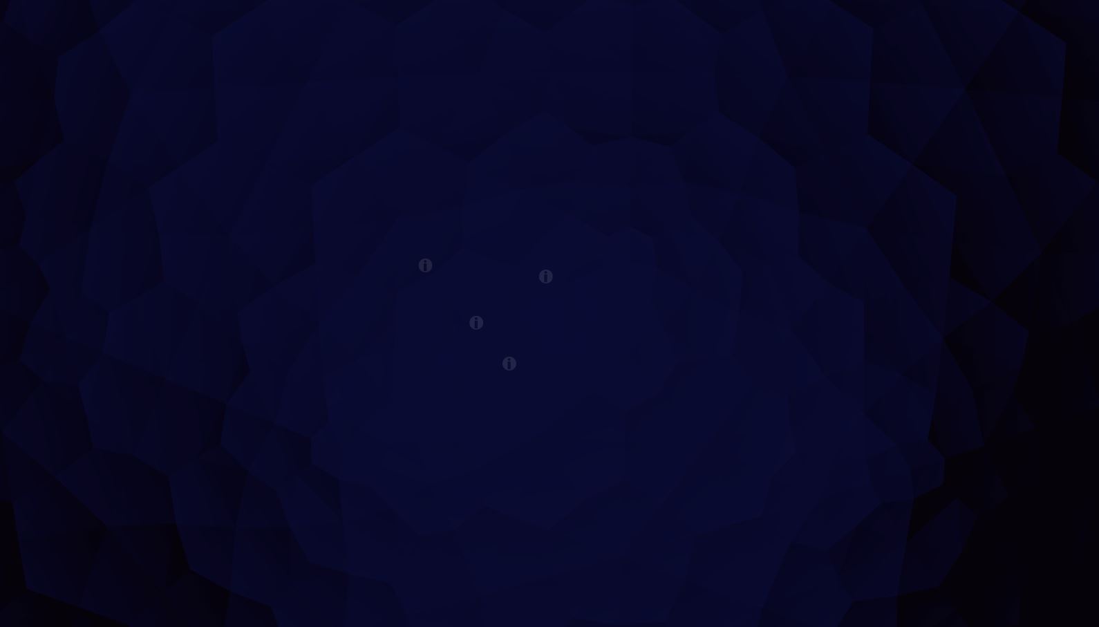

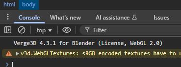

    I’ve picked up a Blender project I was working on using Verge3D, and to my surprise, after updating both Blender (4.4.3) and Verge3D (4.9.2), the meshes are no longer visible in the scene. I can only see the outline when I hover the mouse over them.
    The objects use very simple materials—just solid colors, nothing complex.
    Has anyone experienced this issue or knows what might be causing it?
    I’m attaching screenshots for reference.
    Please note that what appears in the captures as an “i” icon are annotations—when clicked, they display additional information.
    Thanks in advance!

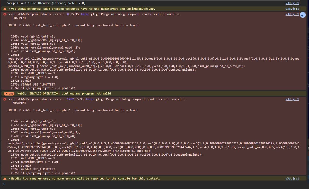

    #82297
    Perhaps you did not reexport your Blender scenes. Could you please share what is printed in the browser console?

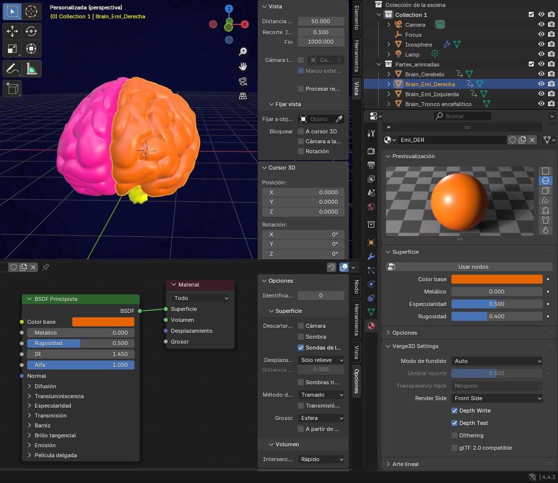

    #82306
    I’m attaching the screenshots as well as the configuration from Blender. Before updating both programs, everything worked fine. I’m not sure if the update requires materials to be applied differently in order for the objects to be visible when running Verge3D. All the meshes are set up the same way in terms of materials.
    #82309
    The console shows your app still uses an outdated engine runtime from Verge3D 4.3.1 causing crash with newly exported assets. Please update your application by following this guide.
    #82310
    See the very first line on your first screenshot…

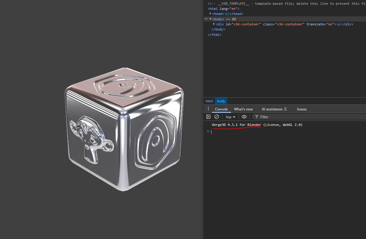

    #82312
    That was the first thing I tried. I also tested the second method from the guide—creating a new project and overwriting the files—but that didn’t work either.
    I don’t understand why, if I have the application updated, when I create a new project and run it, the console still shows that the Verge3D engine version is 4.3.1.
    I’m attaching screenshots.
    #82325
    We checked your license and it appears to be expired last year. App Manager includes a failsafe method to prevent your apps from switching from the licensed version to unlicensed (trial). Please update your license or stick to the latest version available (I believe it’s 4.6).

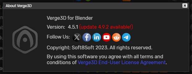

    #82340
    I had to install version 4.5.1 of Verge3D in order for it to work properly. Even so, when I open the console, it still shows that the engine version is 4.3.1 (not the version I installed).
    I assume I won’t be able to update to newer versions anymore, although when the tool was purchased, we understood that the license was perpetual and that the payment was for technical support, not for updates to the tool.
    Thank you very much for the support.
    #82343
    4.5.1 version should be available for you. Please enter your license key anew, then update your application to see if the issue is resolved.
    In general, the license is perpetual, and you are eligible for all Verge3D updates issued within 12 months since the day you purchased the license. We’re going to keep it this way.
