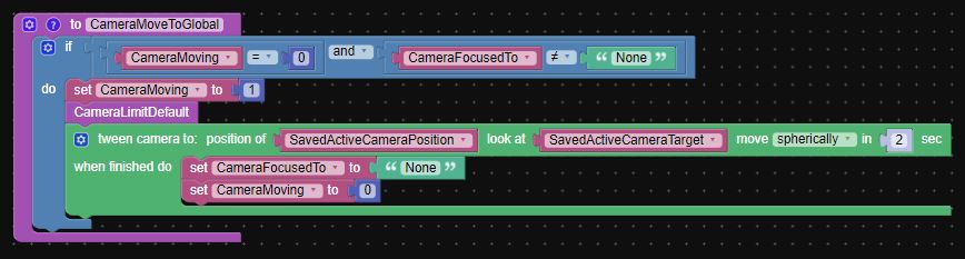

    I embbed my V3D app into an iframe and I would like to call a custom procedure puzzle from the parent javascript.
    For exemple doing something like that :
    var iframe = document.getElementById("verge3diframe").contentWindow;
    iframe.v3d.apps[0].CameraMoveToGlobal();
    Thanks.

    #39151
    Crunch
    try
    document.getElementById(“verge3diframe”).contentWindow.v3d.puzzles.procedures.abc();
    where “abc” is the name of your procedure in puzzles.
    #39152
    Crunch
    line 50

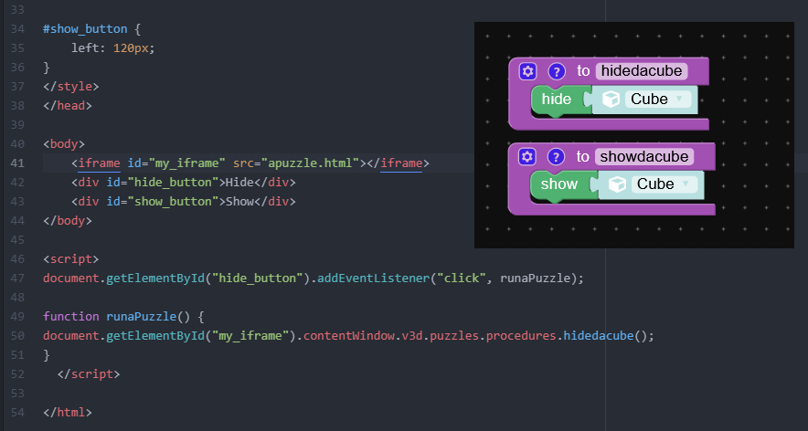

    #82927
    c4cc
    sorry for replying to a late question, but to Alex or Yuri, what is this puzzle named as a function()? (e.g., initfullscreen() ? )
    Intended code:
    function defscrdis() {
    document.getElementById("gamescreen").contentWindow.v3d.puzzles.**();

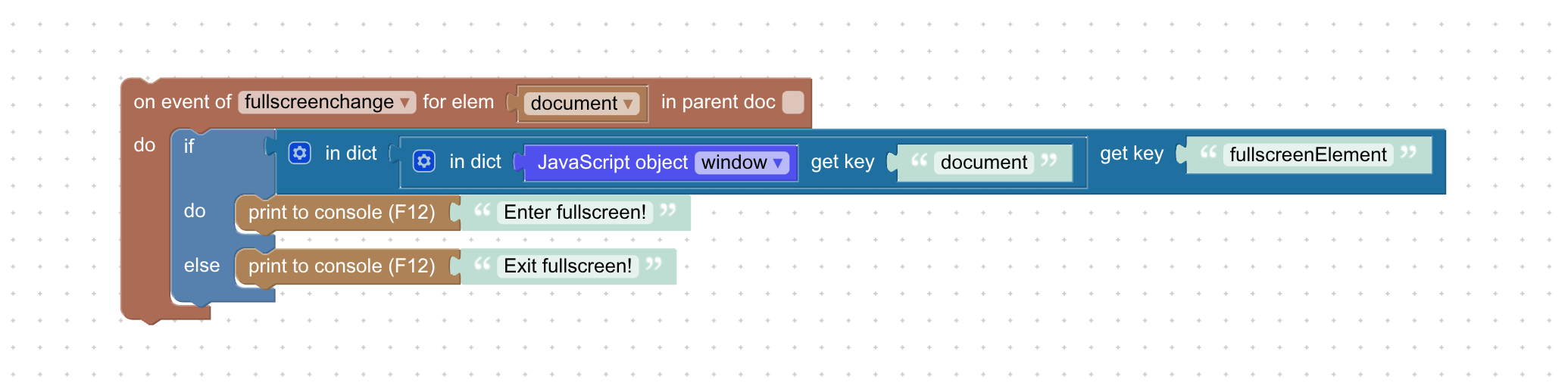

    #82930
    Basically, I’m trying to reduce distance number of objects when window screen, and increase distance number when fullscreen.
    No, the “init fullscreen” puzzle is used to make a custom HTML element behave as fullscreen button. What you really need is to register event handler for “fullscreenchange” event. Upon entering the window.document.fullscreenElement property would be non-nullish, so you can use this fact to distinct enter/exit actions. Check out the following example:
    puzzles to handle fullscreenchange envent

    #82942
    bigmike814
    you can call puzzle functions from outside of visual_logic with v3d.puzzles.procedures.myFunction
    I don’t know that it will work through an iFrame though.
    edit: the guy above posted your answer a long time ago.
    function runaPuzzle() {
    document.getElementById(“my_iframe”) .contentWindow.v3d.puzzles.procedures.hidedacube();
