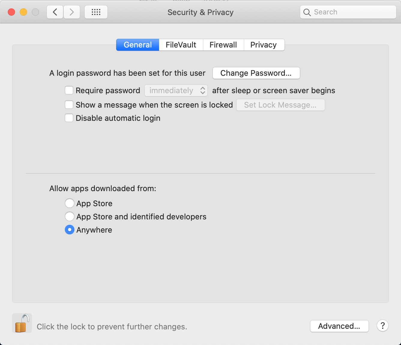

Alexander KovelenovStaffWill it help if you temporary disable the macOS Gatekeeper. To do so, launch terminal and type:
sudo spctl --master-disableThen go to System Preferences -> Security & Privacy and set “Allow apps download from:” to “Anywhere”:
