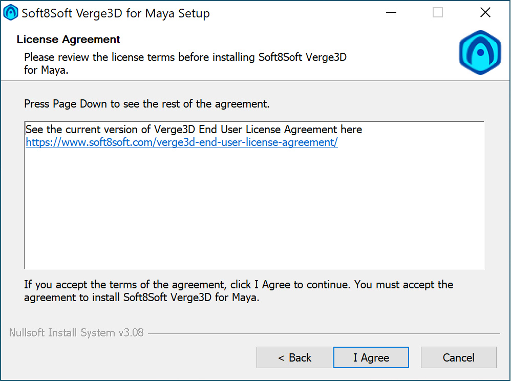

Follow the link to read the recent version of Verge3D license agreement.
Verge3D for Maya EULA

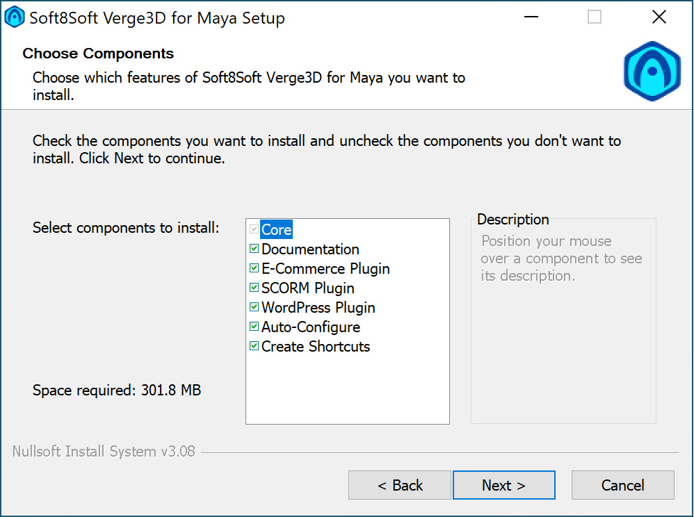

Choose components you want to install.
Choosing Verge3D components

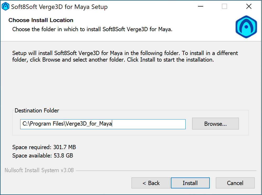

Choose an installation folder that have enough permissions for reading and writing (or better leave it by default).
Choosing installation folder in Verge3D installer

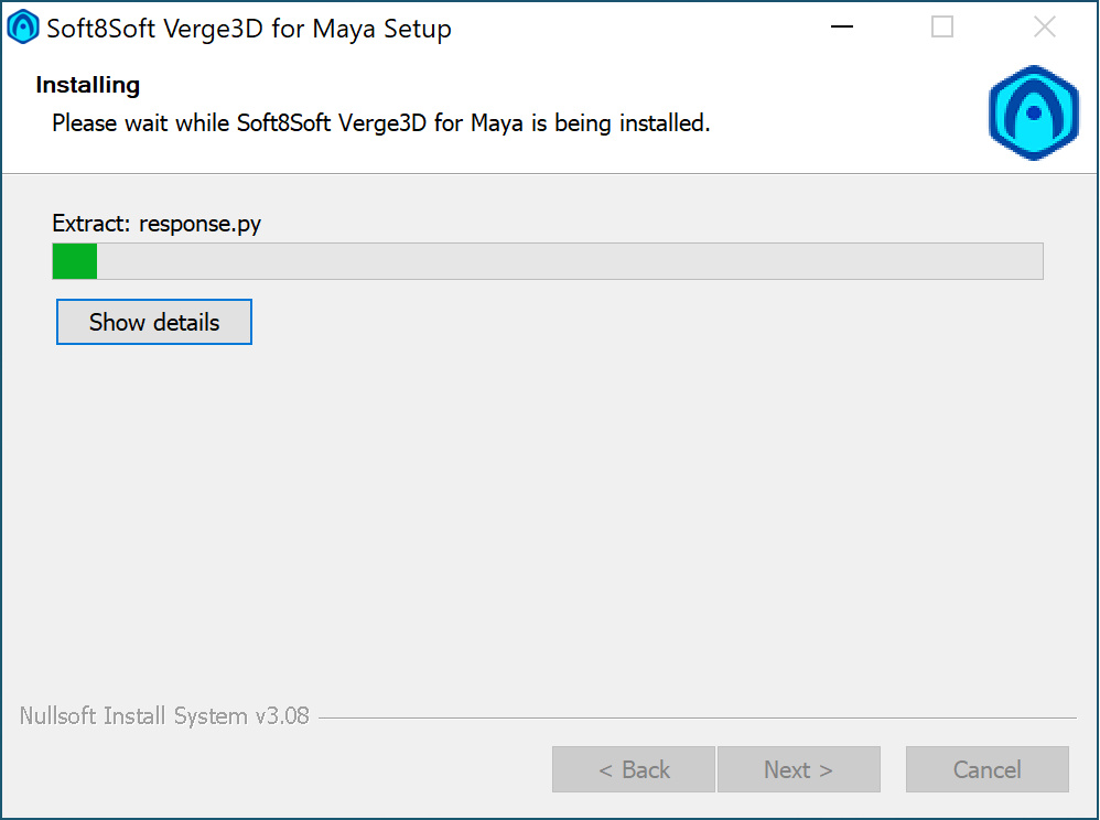

Wait until the installer finishes copying files to the target directory.
Verge3D installation work-in-progress

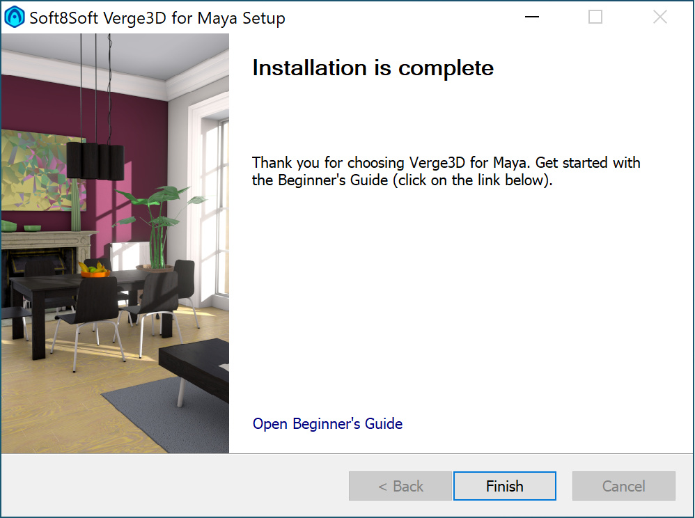

Once installation complete you'll see the following screen.
Verge3D installation complete

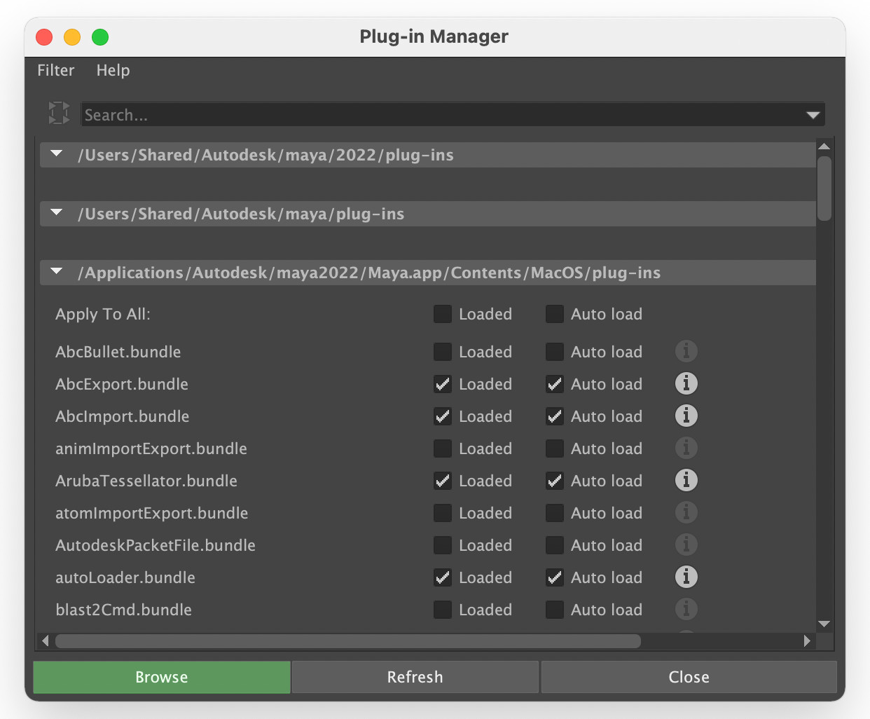

Now you may open Maya. If you had it running, be sure to close and open it again. Now go to Plug-in Manager settings...
Running Plug-in Manager in Autodesk Maya
...and activate verge3d.py plug-in by enabling both Loaded and Auto load checkers.
Activating Verge3D plug-in in Maya

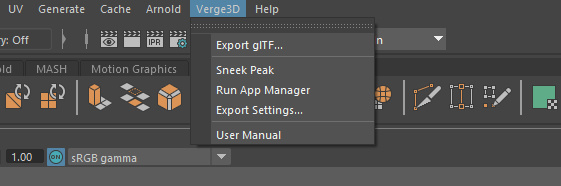

Now you should see Verge3D menu in the main menu bar.
Verge3D menu in Maya

Now open Maya and go to Plug-in Manager settings...

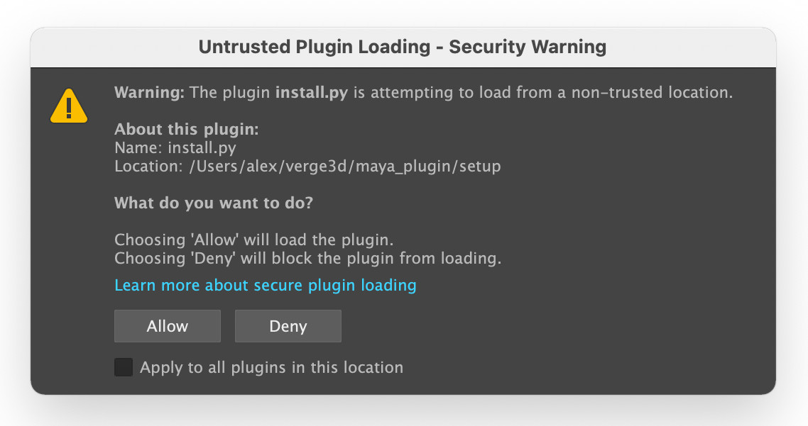

then go to the VERG3D_UNPACKED/maya_plugin/setup directory and open the install.py script.
Loading plugin script in Maya
