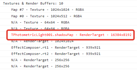

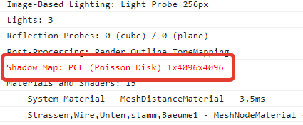

ParticipantHere is the reason
A huge shadow map is able to crash Safari on any iPhone )))

tphotometriclight001.shadowMap – 16384×8192 ?And I only have one light in the scene ?

Yuri KovelenovStaffwhere can I adjust the second parameter:
tphotometriclight001.shadowMap – 16384×8192 ?this should go down when you reduce the size of your shadow map.

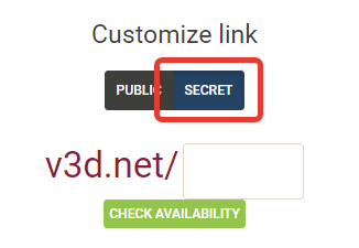

Yuri KovelenovStaffIs it possible to do the same for secret links?
what do you mean by secret links?
you can use v3d.net to manually generate links of any length and kind 2023-04-04 at 9:07 am #61659kdv
Participantwhat do you mean by secret links?

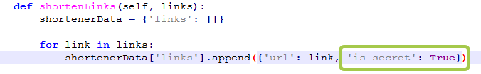

This option allows to generate a link likehttps://v3d.net/xxx/yyyy. Now public aliases are not re-generated again if the specified url have been used earlier, but secret ones are new after every re-uploading. It wouldn’t be a problem if the previous secret link is deleted before generating a new one.you can use v3d.net to manually generate links
I’m talking about the url shortener API in Verge3D server.
