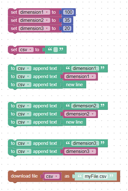

I have been using the csv file reader puzzle but now I need to write some variables to a csv file. Is it possible? How can I do it?Thanks,

I made some search but didn’t find how to do it. I don’t have skills on JavaScript programming.Here is what I am trying to do:
I have some variables in puzzles like
dimension1=100
dimension2=35
dimension3=20
………=…Then I need to write a CSV file with this format:
dimension1;100
dimension2;35
dimension3;20
……….;..This file will be used in a 3D CAD software that uses those parameters to build a 3D Part.
Any help will be appreciated. :)
Thanks,
Nuno2021-07-08 at 10:56 am #42636
Ivan LyubovnikovStaffHi,
You can use the HTML->download_file puzzle for that, but you need to generate the CSV content first. The puzzle setup may look like this:
– first you put the variables into a CSV string, which then goes into the download puzzle.Attachments:

ParticipantHi, Ivan.
I tested and it worked fine. Thanks! :)
