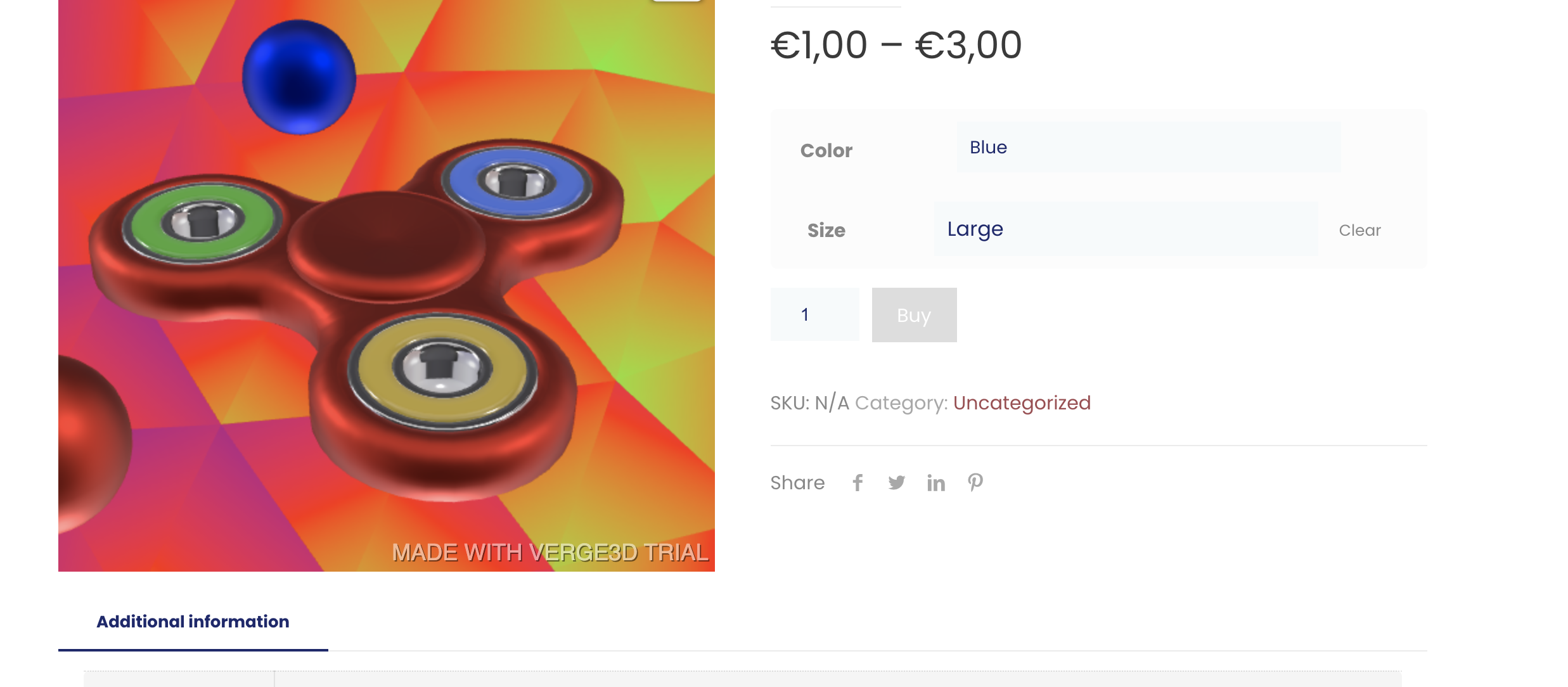

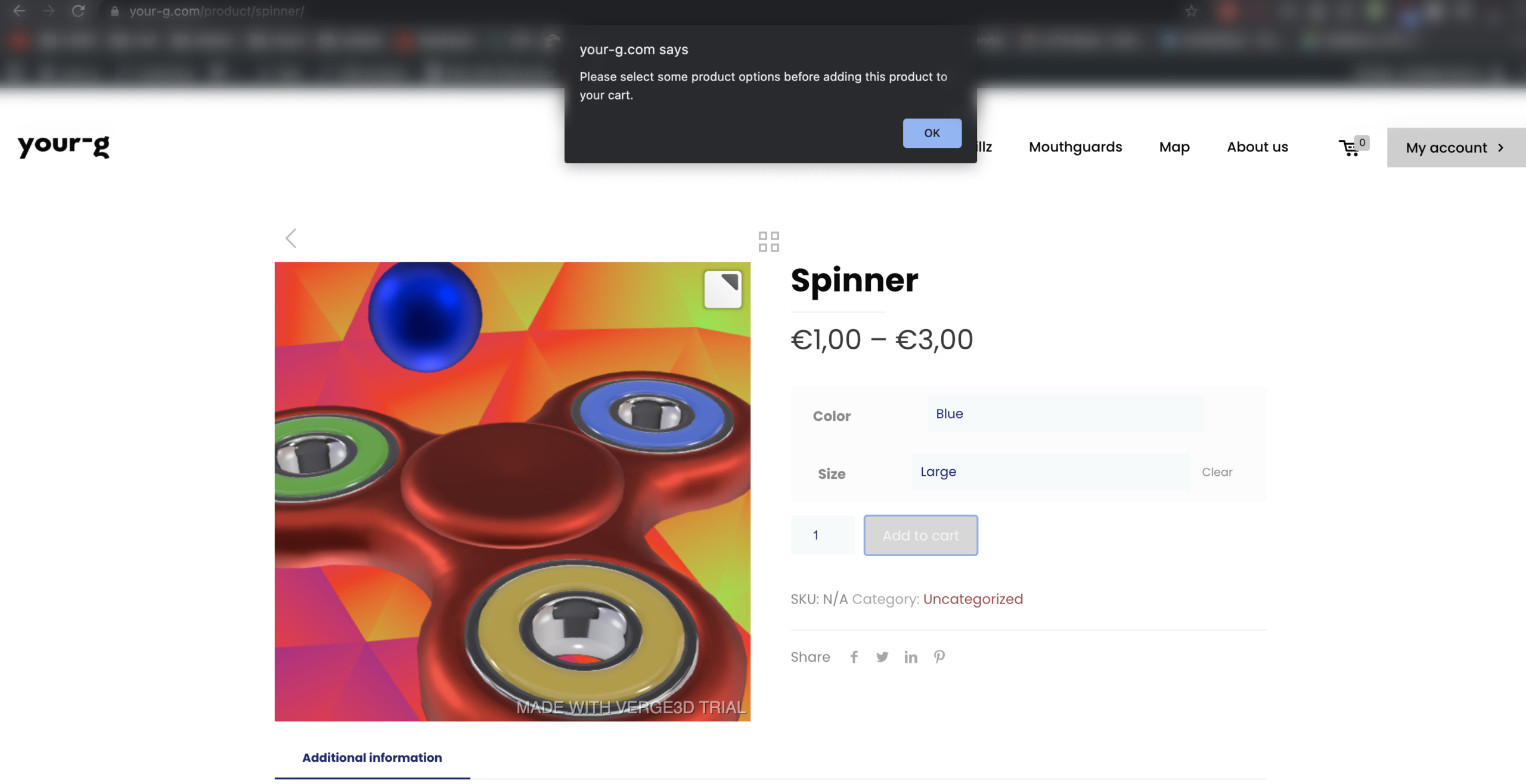

    zordans
    Here is what I’m getting.
    When clicking on the different options, the spinner doesn’t change it’s color or size.
    The add to cart button also is disabled and greyed out.
    Clicking on it gives this warning: “Please select some product options before adding this product to your cart.”
    I’m also getting some new errors and warnings with the Verge3D plugin installed.
    Is there a way to fix it?
