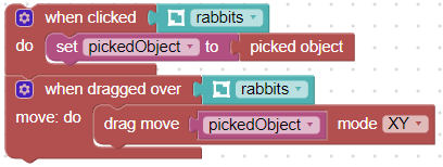

    i put a group inside this puzzle, instead of a single object, the resulting dragged object is a empty object with childrens parented to it.
    it used to work before, cant remember which version,

    Empty objects can be moved/rotated/scaled, but they can’t be clicked/hovered/dragged over. They are not rendered, they are just invisible points (coordinates) with no dimensions. This won’t work and has never worked.
    The when dragged over puzzle works with groups or lists of objects this way
    If you want to move the whole group then you should use the group as a target.

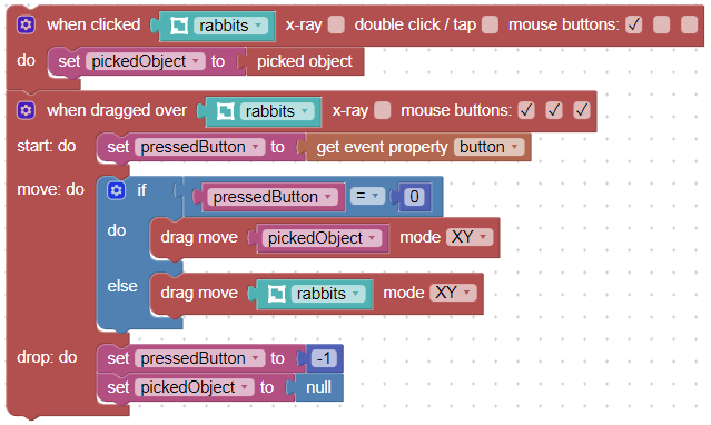

    A combination of methods: the left button moves individually, other buttons move all at once.
    https://v3d.net/a3r
