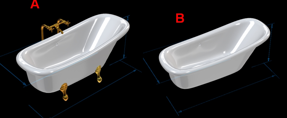

    Thx for sharing and also would like to add. I m not sure about 3.9 to 4.0 but I experienced something when upgraded to 3.9.
    Some scene objects from previous scene were disappeared in upgraded 3.9 verge version. I had to play a bit and then somehow I could fix one file but later even I forgot how I did it.
    Look the image if I click gltf file then it looks like this & when I click html it looks like this. This is from the app manager.
    Some object ( golden tap & pipe) disappear when viewed from html clicking.
    Any specific fix for such thing?
