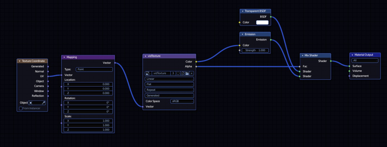

So I’m pretty psyched about the new ‘use canvas/video alpha’ settings option on the replace texture puzzle.
There’s a lot of potential with using this to create incredibly immersive effects, whether it’s just straight video, OR.. animated menus and interactive motion graphics effects.using this simple node setup i got it to work correctly…
I headed over to actionvfx.com and snagged some free cartoon style animations with ALPHA channels (what i was looking for to test).
Using Adobe After Effects, then exporting through Adobe MEDIA ENCODER, I converted these .mov files into .webm files (one of the alpha-channel compatible formats that verge3d can use).
Made sure I exported with alpha channel, then messed with resolution and bitrate to get a very low KB size for the resulting files.
in the demo i link here, – the full-screen cartoon smoke is 131KB
, while the small puff cartoon smoke video is only 68KB!Check out a very bare bones simple demo I made of this in action HERE!
I’d like your feedback on whatever mobile browser you may using.
I found the playback quality choppy on duck duck go’s mobile browser, but nice and smooth on Chrome and Firefox mobile.Fun stuff!
