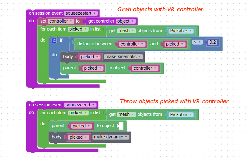

    I am trying to make a simple scene with VR and Physics. I want to pick up the cube with the trigger. Please let me know how do it if you know. If I make a new scene and activate VR and Physics, then go in VR mode the browser hangs indefinitely on the headset. I cant get this to work.
