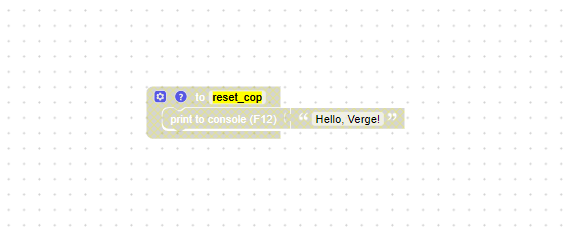

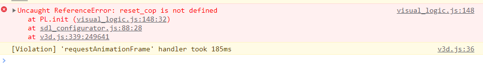

2022-06-17 at 9:49 am #53246marinourso
ParticipantCiao a Tutti
volevo segnalare che in console vengono visualizzati errori riferiti a procedure che però sono disattivate2022-06-17 at 11:22 am #53249
Yuri KovelenovStaff@marinourso reproducing this bug on our side, will look into!

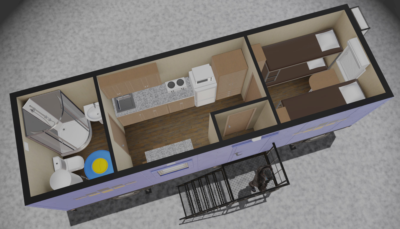

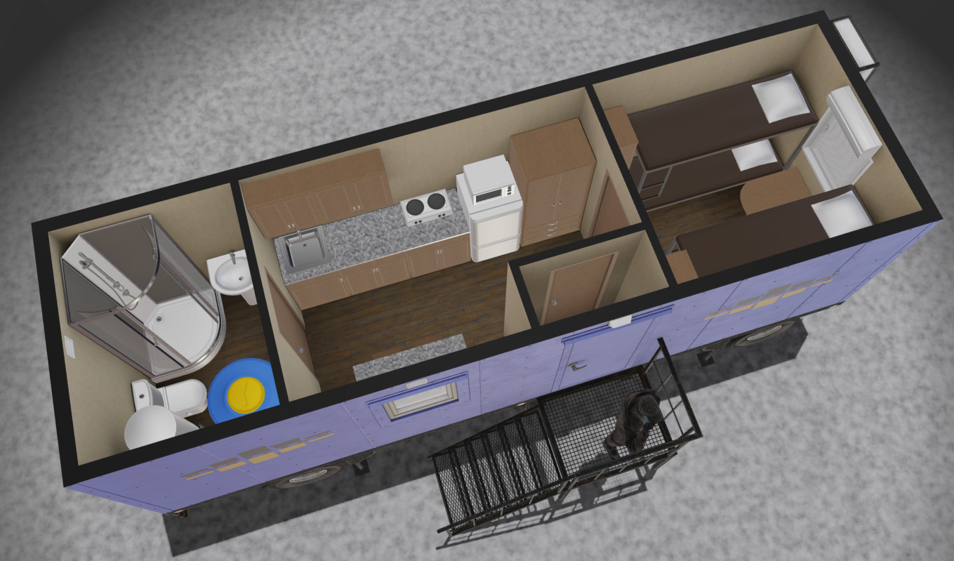

2022-06-17 at 5:11 pm #53266kdv
ParticipantTexture compression is intended to reduce video memory footprint
agree, it works
.ktx2
vs
.jpgone more problem: the picture in 4.0.0 looks foggy and faded. in 3.9.1 colors looked more rich (just compare two pictures below)… is it really necessary to activate
ToneMappingwhen activatingMSAA x16?visually it seems that the HDR rendering is active by default (
AA "Auto") regardless of the option"Use HDR rendering"and colors look normal, but when any of post-processing methods turns active (AA "MSAA x16", for example), the HDR rendering turns on/off according to this option
p.s.
ToneMappingcan be deactivated and the colors will be nearly the same they were in 3.9.1…
app.postprocessing.toneMapPass.material.toneMapped = false;
or the app should be re-exported with “Use HDR Rendering” option. this also helps…Puzzles and JS coding. Fast and expensive.

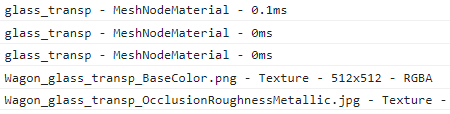

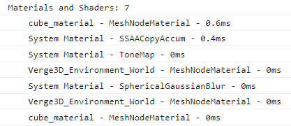

2022-06-20 at 8:43 am #53349kdv
Participantwhy some materials are created twice or more?
3.6.1 doesn’t have this issue…Puzzles and JS coding. Fast and expensive.
