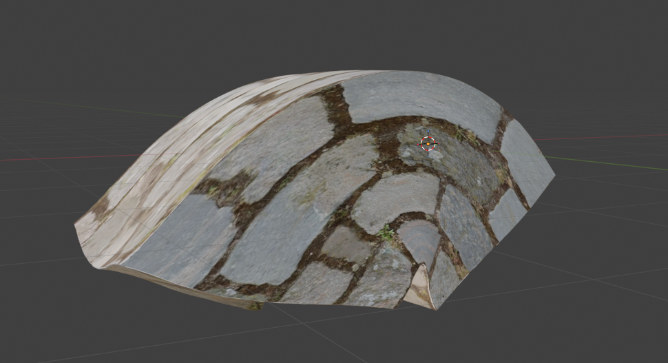

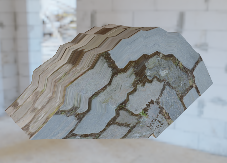

ParticipantI did try something and i might be something wrong with bone

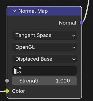

And i try another thing in my project, when i apply material it have error. When i removed the material it suddenly ok. When i apply material back and deleted the normal map it ok
I’ve found solution: if i replace normal map node with bump node, it work2026-07-22 at 9:59 am #88115

Mikhail LuzyaninStaffSeems like it’s a bug, we’ll fix it in our next release, but for now you can export your scene from the first frame, it helps to fix the bug.
