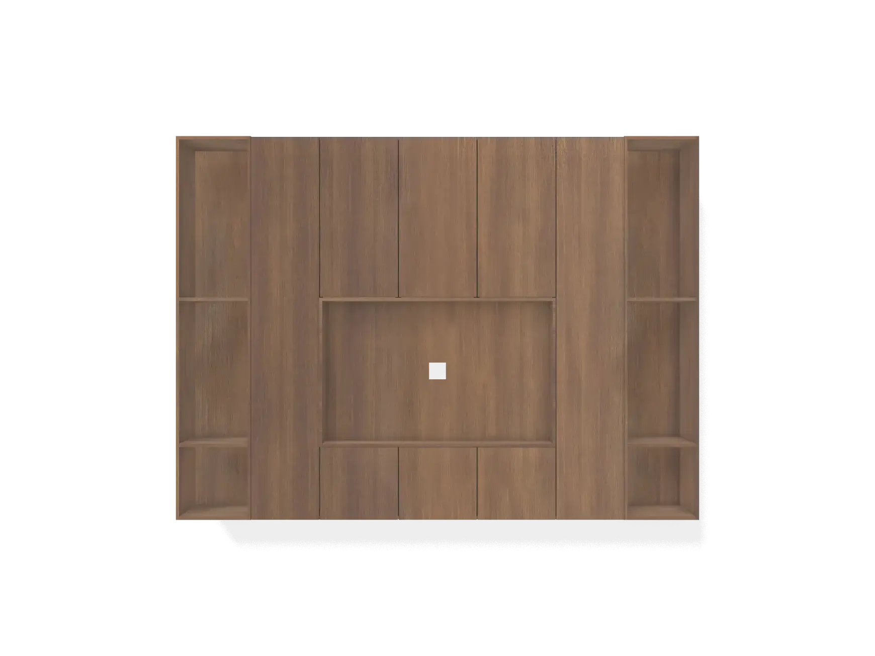

    I’m trying to take screenshots of cabinets in our 3D configurator. The screenshots should show the cabinets and the shadows they cast on the floor and wall, but the floor and wall themselves should remain invisible.
    I tried recreating the shadow catcher material from the Verge3D AR example, but I think I’m missing something because the shadows are not visible in Verge3D.
    I’ve created a small example project here:
    shadowcatcherExample
    Could someone point me in the right direction or explain what I might be doing wrong?

    It’s a fake effect so it’s always need some tweaks. Here’s a file. Also for good effect of sharp shadow better to use sun.
    #88205
    martenmonoz
    Thank you very much! with some tweaking I got the effect we were after :)
