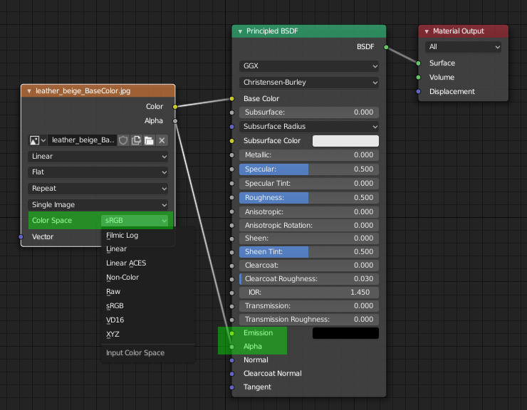

    Dear Verge3D users,
    To reflect several significant changes introduced in the latest Blender 2.8 builds, we decided to release another maintenance update for version 2.12
    General
    Fixed silhouette artifacts manifested when the transparent background and the HDR mode are enabled at the same time.
    Blender-specific
    Fixed export of Panoramic cameras.
    Light energy values were made consistent with recent Blender 2.8 builds.
    Latest Blender 2.8 build introduced a new interpretation of color correction in EEVEE Image Texture and Environment Texture nodes. Namely, instead of the simple Color/Non-color switch they offer a variety of color space modes, the most popular of which are now supported by Verge3D.
    recent changes in Principled BSDF node
    Latest Blender 2.8 also added 2 new inputs to Principled BSDF node: Emission and Alpha. They now work with Verge3D without crashing the export.
    Finally, Verge3D now handles the Transmission input in the Principled BSDF node consistently.

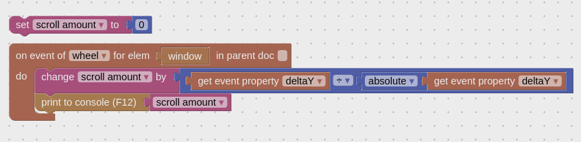

    #14952
    Crunch
    Sweet, DeltaY property! I am ready to start using my scroll wheel to control objects but how do I go about that? Any examples any where?
    I did some experiments with the wheel event a while back
    https://www.soft8soft.com/topic/scroll-event/
    In that experiment, I added a transparent div block (100% width and 100% height) over the whole scene and that way, I could get the event to fire when I used my mouse scrollwheel but the div blocked the whole scene from any other interactions.
    Doing the same thing with V2.12.4 I can get the event to fire and returns a -3 if down and +3 if scrolled up, but there has to be a better way? I tried using the Body, Document, and Window as the element in the “on event of wheel” puzzle but couldn’t get anything to fire, let alone return the DeltaY property.
    What am I doing wrong? Help!
    Thanks
    #14960
    this is a nice approach – another one can be setting the camera to No controls
    should work with window, just tried that myself :)
    mouse scroll with puzzles

    #14994
    Crunch
    Yuri I am a big fan of using the no-control camera, but it has a drawback. It doesn’t work in the camera tween puzzle. (or at least last i checked?) Any chance you could fix that?
    For any newb vergers like me who didn’t understand what deltaY property is all about until just recently, its way to determine which direction the user scrolled their mouse wheel. Up until this upgrade, the on event of wheel would fire if user activated mouse wheel, but not tell you which direction the wheel went. From my experiments it appears if user scroll forward it returns -3, if scrolled back, +3
    Re-create the attached puzzle screenshot and it becomes self-explanatory
