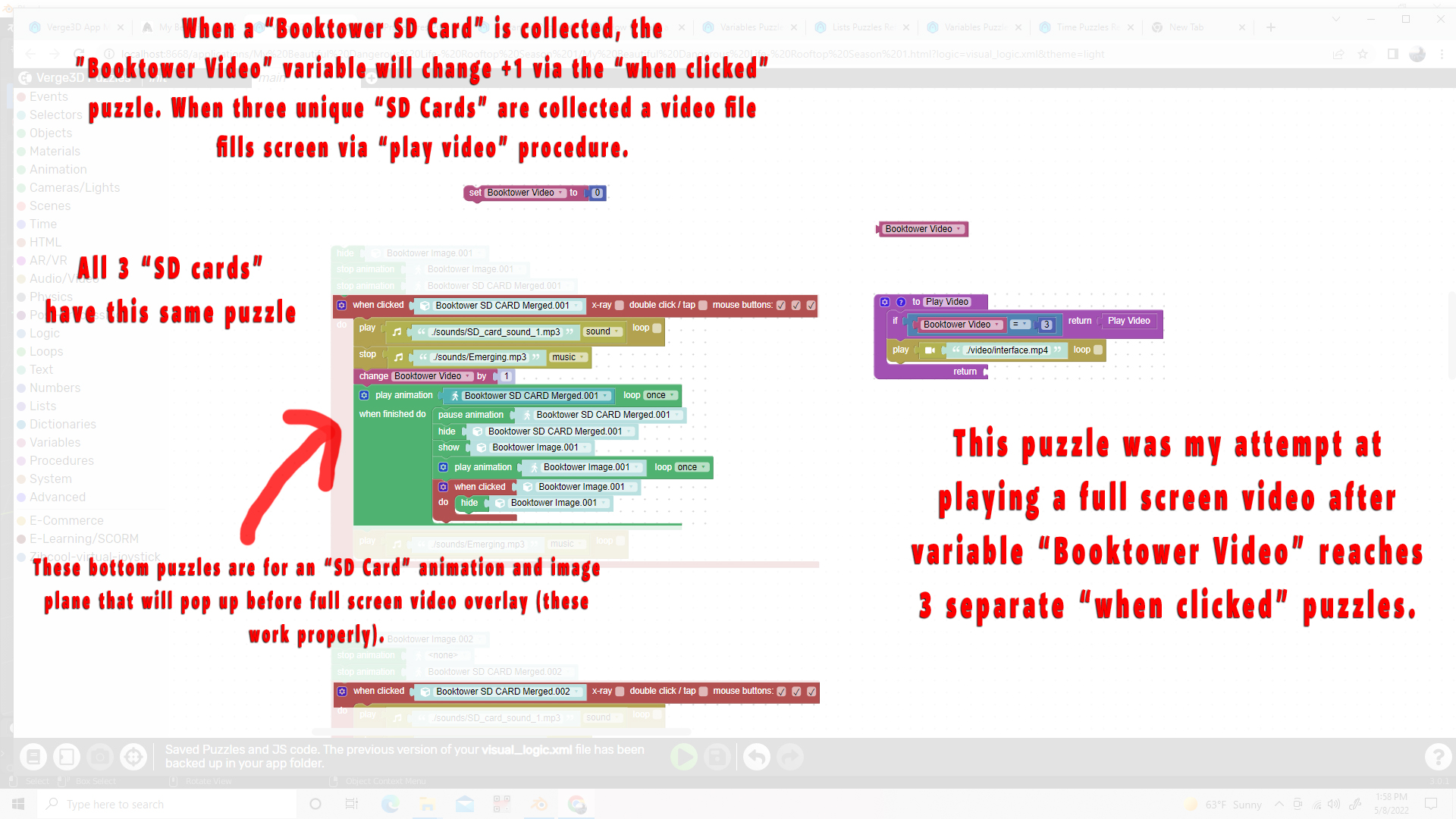

    1. Which way is more optimal for performance as a phone app? A video overlay via verge html video puzzle, or via Webflow embed? The videos would fill the screen, play, and then disappear and return back to the 3D world camera.
    Also I am trying to do the full screen overlay within verge 3d via html video puzzle as you suggested. But I can’t tell how to make the video play with verge 3d puzzles. Most of the documentation/app template is geared towards if you are applying the video as a texture to an object not as a full screen overlay. *Theres an image attached below related to this question and the next few.*
    2. When I test my app on an actual iPhone, it is already hardly loading, despite using LZMA upon blender export. The scene is about 60k vertices and I’ve yet to add the ten minutes of video. There is hardly any lighting other than building textures with emission shaders baked in blender. I am not sure what I am doing wrong. It constantly refreshes the favicon load at 100%, or loads with missing textures.
    3. So verge is essentially writing the javascript for me and after it leaves verge its treated like normal JS?
    4. I am attempting to use the variables and procedures to do as you suggested, I have read a few different forums but unfortunately cannot figure it out. Do these puzzles look correct (see attached image)
