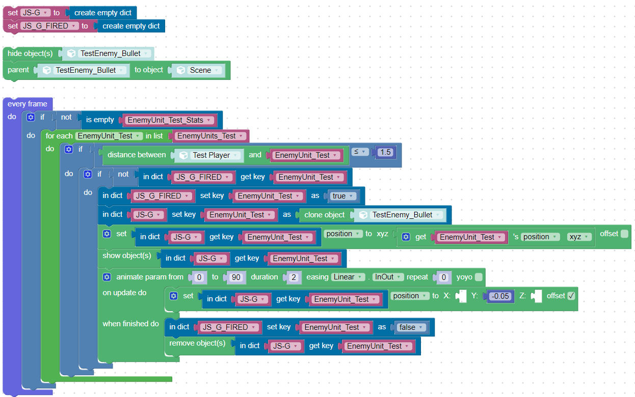

c4ccParticipantEnemies shooting when the player is within a certain range. Yet when the player is within that range, only 1 cloned object shoots.
I have clones of both an object and its bullet in a list that I need to activate individually when within range with the main object.
Also, how do I get rid of that original shot that activates whenever player is within range of the enemies in list. Because that original shot looks out of place, compared to its clones
Verge3d app:
https://drive.google.com/file/d/1aXbk1L74iIc4bVgJS459qpXkSbeSPXrc/viewFPS trialproduct 20.9.25 https://postimg.cc/gallery/LMM5vkQ/af43346e

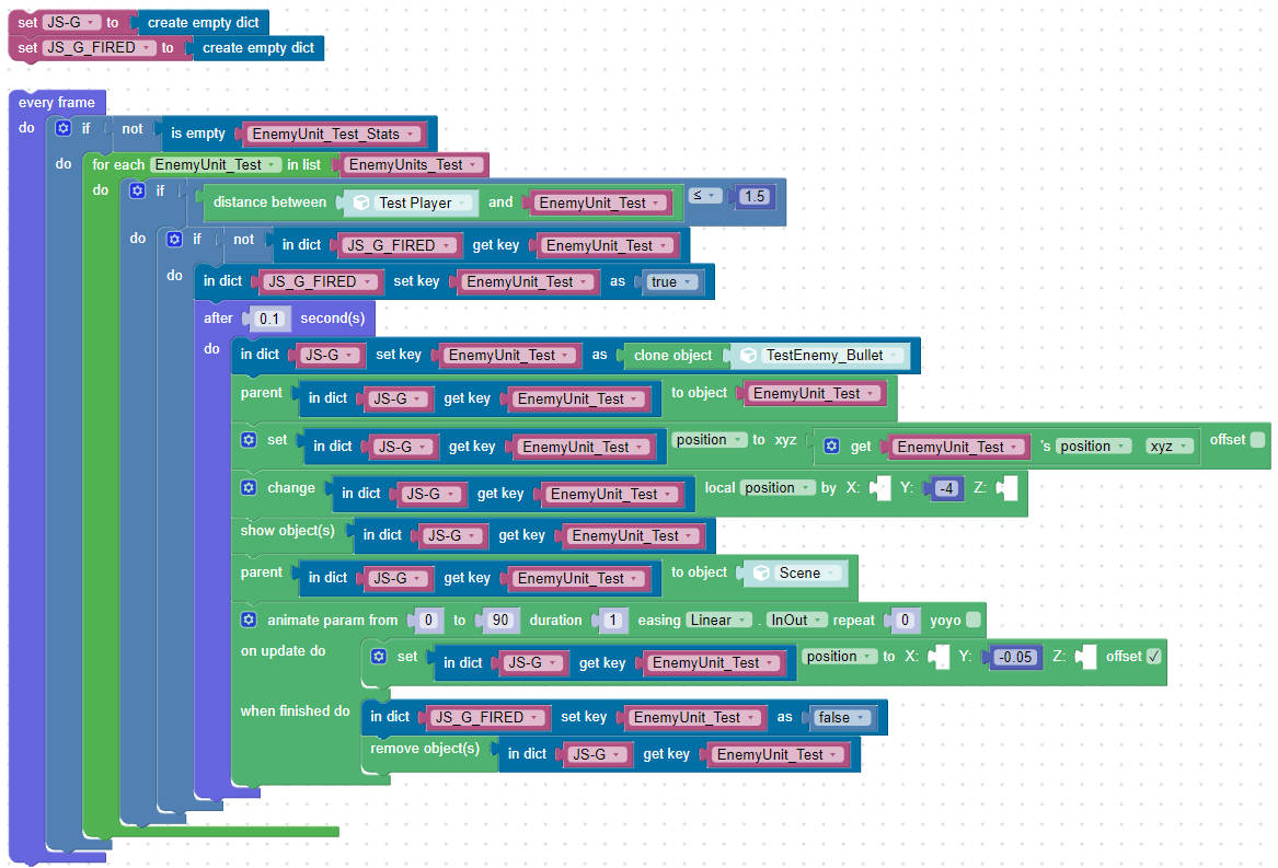

xeonCustomerHi c4cc…. hope you have figured this out by now…. your questions are very specific to your puzzle and your own logic flows…making it very hard, at least for me, to dive in and find a quick answer.
My initial guess is the logic timing….do you have a timing map or visual that shows all the things you have going on with all these time events? Once you start programming based on time..things can get lost, missed etc making it hard to diagnose. Have you added print to console statements within your loops to diagonose whats firing when and if its ocurreing at the right time?

c4ccParticipantyour questions are very specific to your puzzle and your own logic flows…making it very hard, at least for me, to dive in and find a quick answer.
True, timing especially can throw intended events off. Have to keep this in mind
Have you added print to console statements within your loops to diagonose whats firing when and if its ocurring at the right time?
New zip file for puzzles with print to console(F12). Sadly it didn’t say anything.

c4ccParticipantkdv, thanks for your answer, yes it works and I appreciate it. It’s just that when I either space out the cloned units or make said units move, the shots are fired a distance away from each unit like here.
Any way for the individual shots to appear in front of each unit before said shot is fired? Regardless of position or moving?
Again, your original answer is indeed an important game-changer
