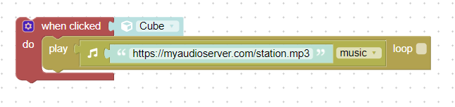

    #40956
    How can i stream shoutcast radio from puzzle scene?
    You need to find a server or build one yourself so you be able to request audio from it via the load_sound puzzle.
    Something like this should work:
    You can go to the Icecast radio directory http://dir.xiph.org/ then open a station and copy its address into the load sound puzzle to test it out.
    #40962
    kamonciks
    Shoutcast radio streams are not give any mp3 files. I added stream adress and it did not work. Your mentionet above as mp3 file but it does not make any sense for shoutcas/icecast radio servers. Any suggestion?
    #40973
    That’s not a file but just an address, so it doesn’t really matter if it has an extension or not. Some shoutcast stations have the mp3 extension, most likely as an audio format hint, for example, http://62.141.38.36:8080/dance.mp3
    Here’s a project example that works for me: radio_player.zip – just click on the cube and the radio should start playing.
