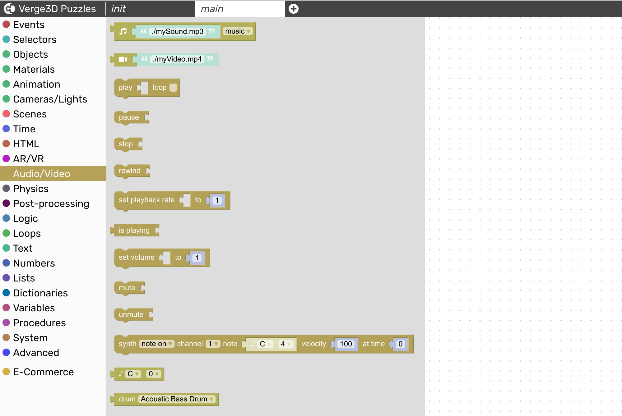

load sound
Loads an audio file using a specified URL. The audio is played via the WebAudio API or HTML <audio> tag depending on the chosen type: sound/midi or music respectively. This puzzle also adds the loaded audio to a memory cache so that any subsequent uses of this puzzle with the same URL do not load the same sound file again. Using .mp3 format is recommended as it is supported by most web browsers.

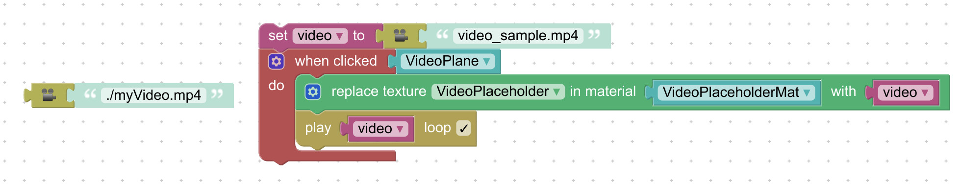

load video
Creates a HTML <video> element and loads a video file using a specified URL. This puzzle also adds the created video element to a memory cache so that any subsequent uses of this puzzle with the same URL do not load the same sound file again. Using .mp4 format is recommended as it is supported by most web browsers.
The load video puzzle does not create any visible elements on your scene. To make it visible, assign video texture to your materials using the replace texture puzzle.
For usage example, check out the Video Texture demo (source files available in the Asset Store).

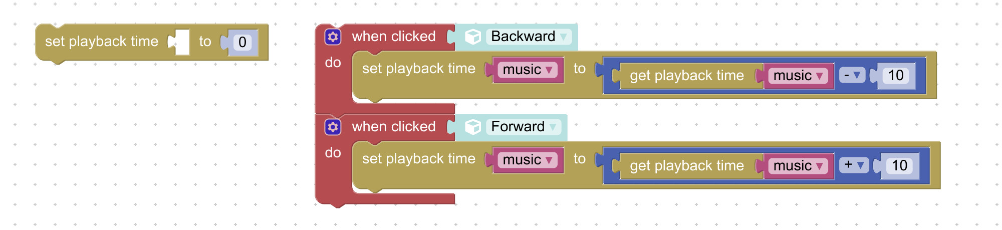

set playback time
Set audio/video current playback time in seconds.
Setting playback time is not supported for sound (WebAudio) assets.

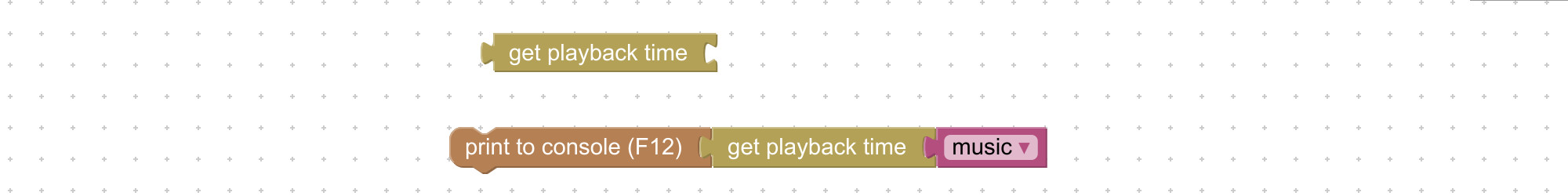

get playback time
Get audio/video current playback time in seconds.
Getting playback time is not supported for sound (WebAudio) assets.

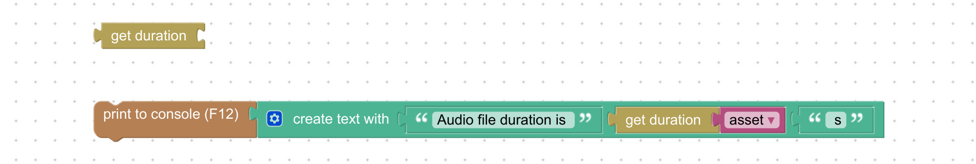

get duration
Get audio/video asset duration in seconds.

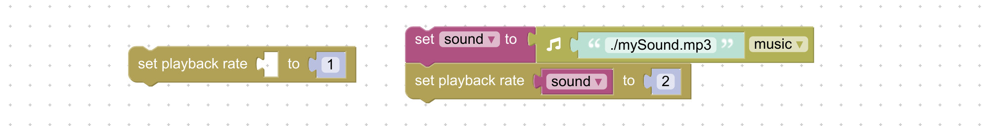

set playback rate
Set audio/video playback rate. Specify value <1 to slow down playback, 1 for normal speed, and >1 to increase playback speed.
Setting playback rate is not supported for midi assets.

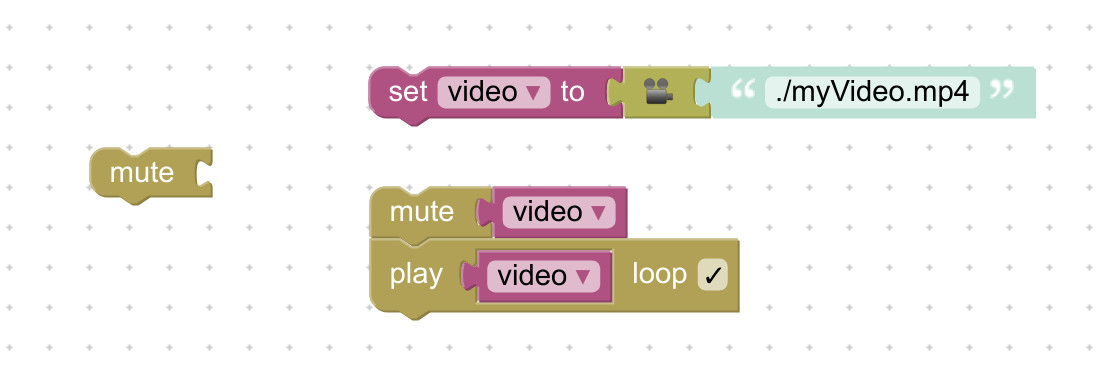

mute
Mute a sound or video.
Apart from controlling audio volume, you can use this puzzle to start video playback automatically. This is possible, because web browsers allow playing muted videos without user interaction.

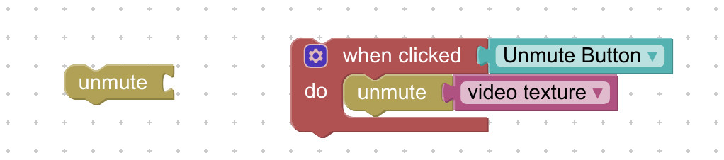

unmute
Unmute a sound or video.

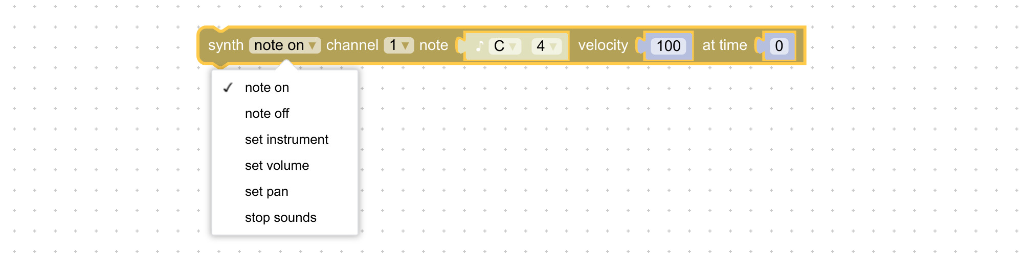

synth sound
Play sound using the built-in General MIDI-compatible software synthesizer (based on the TinySynth library). Various instruments and effects supported.
- note on
- Start to play note using the given synth channel with sound intensity specified as velocity (0-127). Use the at time value to specify playback starting time in seconds.
- note off
- Stop to play given note.
- set instrument
- Set channel instrument from the given list.
- set volume
- Set channel volume.
- set pan
- Set channel pan level.
- stop sounds
- Stop all sounds on the given channel.
To play drums, specify Drums as channel number and use the drum number to select instrument.

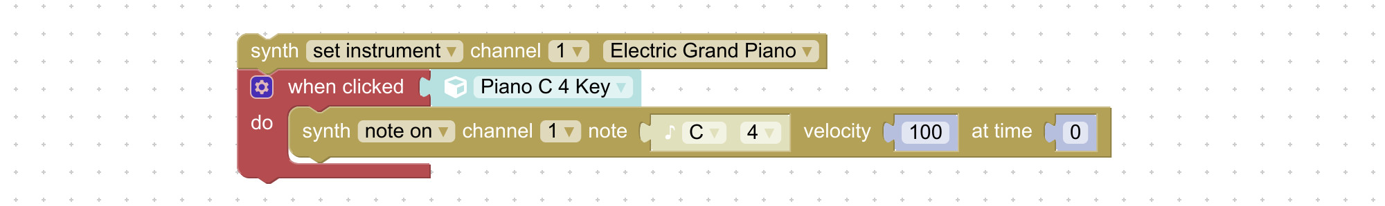

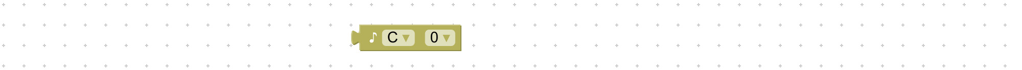

note number
Return note number. Use it to pass notes to the 1-9 channel of the synth sound puzzle.
Octave numbers are specified using the scientific pitch notation, for example C 4 means middle C tone.

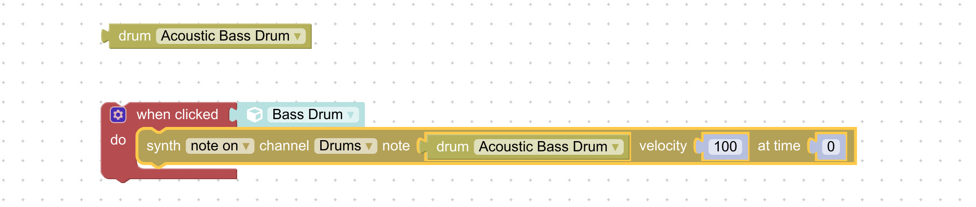

drum number
Return drum number. Use it to pass notes to the Drums channel of the synth sound puzzle.
