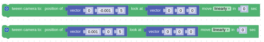

    You might use the tween camera puzzle with slight almost invisible offset to X or Y coordinate, e.g:
    In the first case camera will look -X (left) +X (right)
    In the second case camera will look -Y (left) +Y (right)

    Thank you for your suggestion. I had already identified this tweak that makes the camera “rotate” 90degrees either way…
    BUT I also need to rotate my Camera with a given angle which is not 90° in another use case, and as far as I could see I cannot achieve this result with your tweak. That’s why I searched for a more generic and “clean” way to do it… Do you know where I could find a good explanation of how the camera position and orientation is controlled and how the app.controls influences all this??

    I managed to get what I needed with a little bit of trigonometry, by moving the camera in X/Y direction, with very little distances (approx 1mm is OK) , depending on the angle I want to achieve. This does the job.
