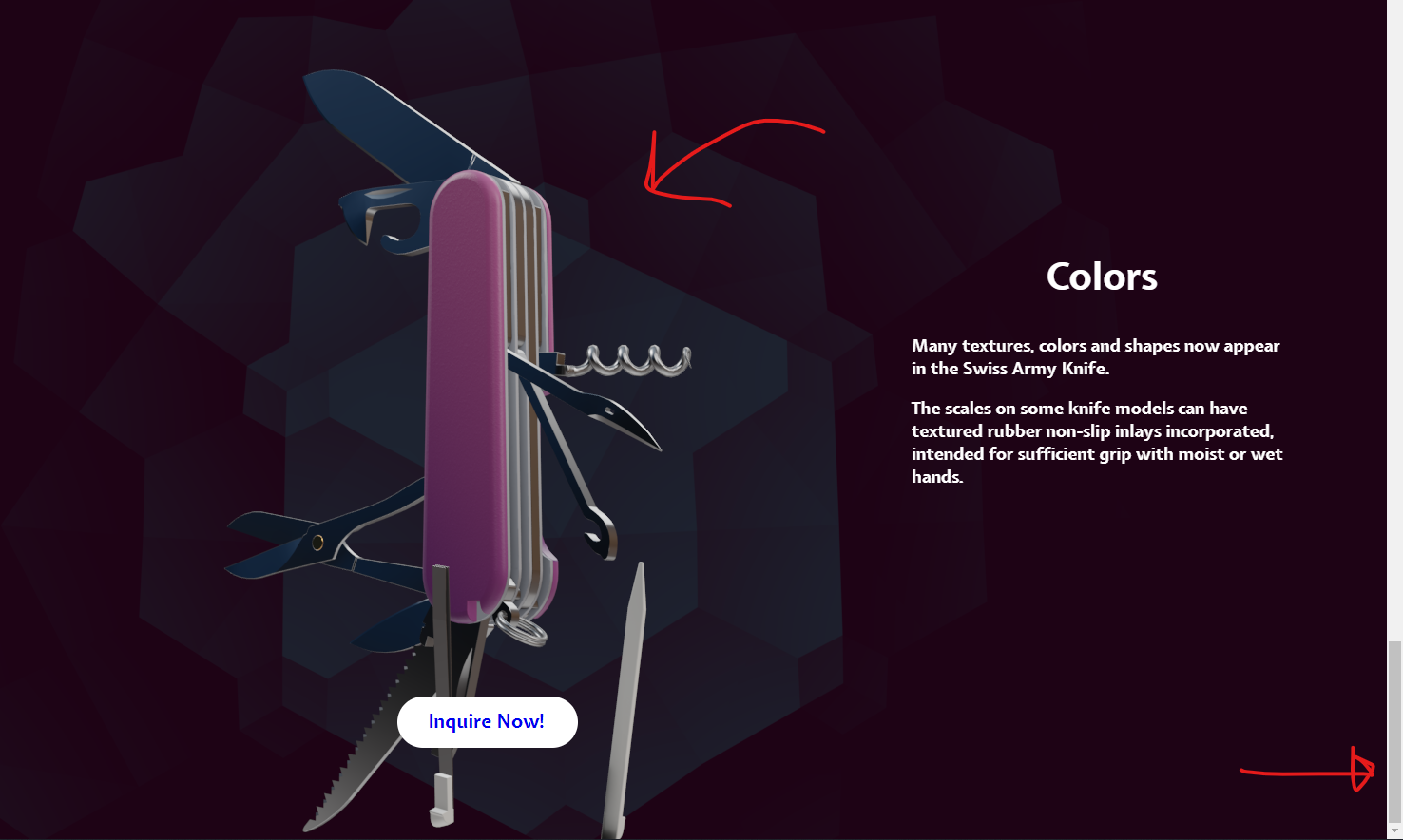

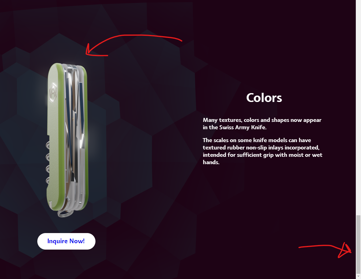

WebenartCustomerit is happening with 2 ways
2)by drag the browser’s scrolling bar by clicking it and dragging it to the top of the page
2) also if i click the middle mouse button and move the mouse to the top.
The same problem exists if you go from the top to bottom as well.
If you see my attached images, i have reached the bottom of the page, and the knife animation it is not on the same frame! to the one image i have reached slow, to the other image i have reached faster.
regards
Webenart | Creative Websites
