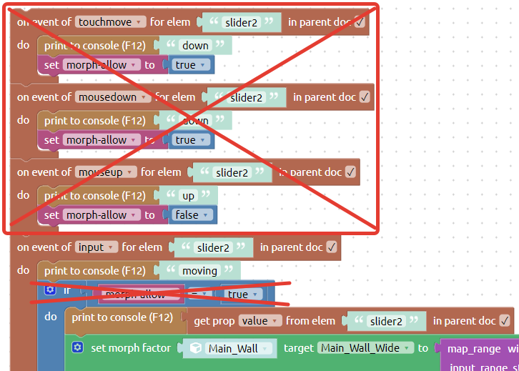

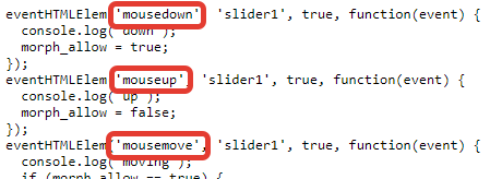

    Why it’s doesn’t work, when using mobile phone?
    Mashud Rana
    3D Modeller | Rendering & Interactive Expert
    www.rana3d.com
    #65831
    Maybe because no mouse is connected to your phone?
    You’d better never use mouse events with range sliders. Use “input” or “change” events.
    #65852

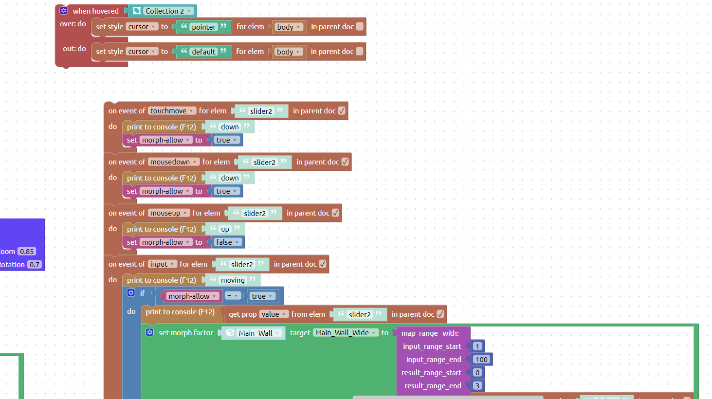

    #65862
    #65890
    mashud008
    Wow, This working great. Thank you
