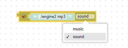

    Hi Michael,
    We’ve recently supported a “type” option in the “load sound” puzzle. If you choose the “sound” type when loading an audio file, then the audio (if looped) will play seamlessly:
    This feature right now is available only in Verge3D 3.4 preview 4 (the latest build) and will also be in the next stable Verge3D version, but you can already try it.
