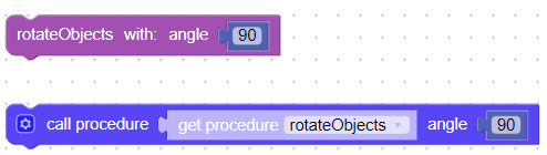

Correction. There is one simple workaround. Replace all procedure calls this way and they won’t disappear when you move your procedures with Ctrl+X/Ctrl+V to another tab.

studiogijsCustomerthanks, will do that in future projects. I looked into the notepad++ solution, but that seemed tedious and tricky.
Your solution still means I have to carefully look where the procedures are called.2024-07-16 at 12:38 pm #75980kdv
Participantstill means I have to carefully look where the procedures are called.
Actually, nope.

studiogijsCustomerwell, not if I do that from the get go, but if I have to replace all calls in my current solution, it still means I have to make sure I replace them all.
2024-07-16 at 1:21 pm #75982kdv
Participanthttps://drive.google.com/file/…/view?usp=sharing
2024-07-16 at 1:41 pm #75983
studiogijsCustomerthanks for sharing the video, in that case moving the function seems quite feasible and faster than replacing the function calls.
But the phrase you quoted refers to the second workaround, not the first.
2024-07-16 at 1:45 pm #75984kdv
ParticipantAgree. The second workaround is mainly for future projects. Replacing all procedure calls could take a lot of time and attention )))
