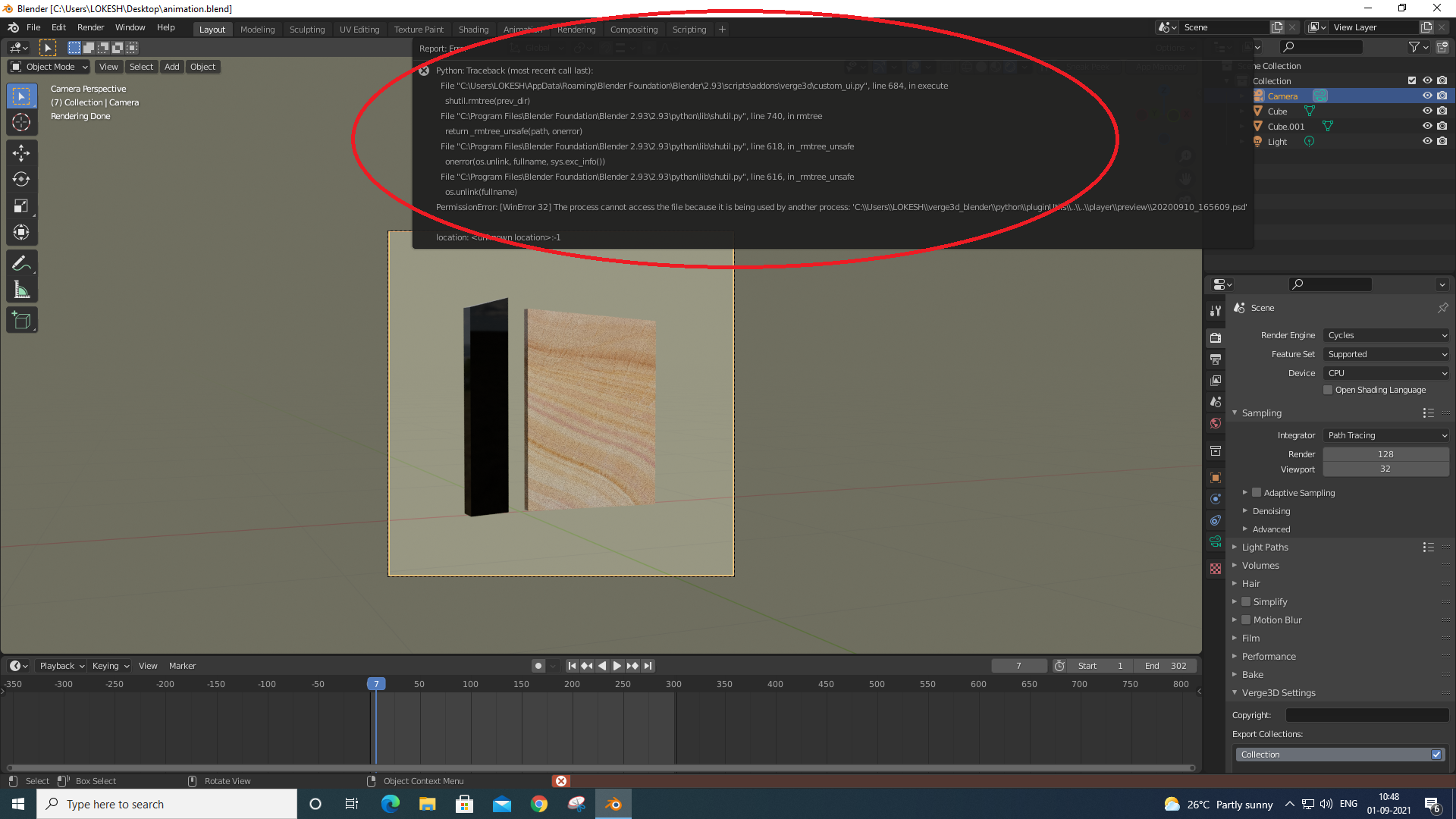

    lokesh
    1) I clicked sneak peek for the first time and the model turned out black
    2) I closed the browser and pressed sneak peek again in blender and it seems like I’m getting weird console errors

    yes, this because of PSD files they not supported but must not cause crash. Convert them to png for now.
