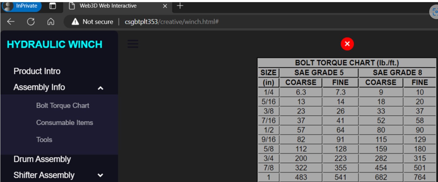

    is it really that simple & straight forward ?
    the error occurring is the content & BG is not loading.
    check the screenshot
    Yeap, it’s really that simple. v3d apps work with no problems. just added several missing mime-types
    .gltf application/json
    .hdr image/vnd.radiance
    .json application/json
    .webp image/webp
    .woff application/x-font-woff
    press F12 and see errors.
