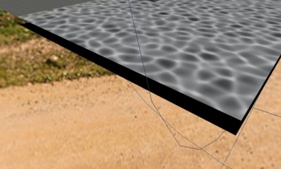

ParticipantHello, I’m testing Verge3D for max since a while ago, to see if it is interesting for our workflow. But there is a problem with materials in my tests. Very often, standard materials with maps appears black, and if I use a Physical Material with a diffuse map and a bump map with different tiling, it doesn’t recognize the correct size of the bump. I have just made the same test with 3.0 but it’s still the same. Is there any solution? Thank you very much

ParticipantHere you have. You will see that the bump doesn’t coincide with the diffuse and reflection tiling.

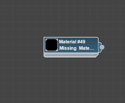

Mikhail LuzyaninStaffWhat a material do you use for that “black” shader. Seems that it’s created with not a standart renderer.
2020-03-06 at 12:57 pm #24410gurifrisqui
Participantwhere is that node? I can’t detect that material in the scene, it isn’t applied to any object, is it?
2020-03-06 at 2:25 pm #24423
Mikhail LuzyaninStaffwhere is that node? I can’t detect that material in the scene, it isn’t applied to any object, is it?
It’s applied to the object under the water. About tiling and bump, it’s not supported yet to tile additional bump map, try to use normal map instead.
2020-03-09 at 2:48 pm #24517gurifrisqui
ParticipantOK, then We’ll try with normal map, but it would be very useful in future releases support for bump tiling.
The material under the water has a white VrayMaterial, which is unsupported.
