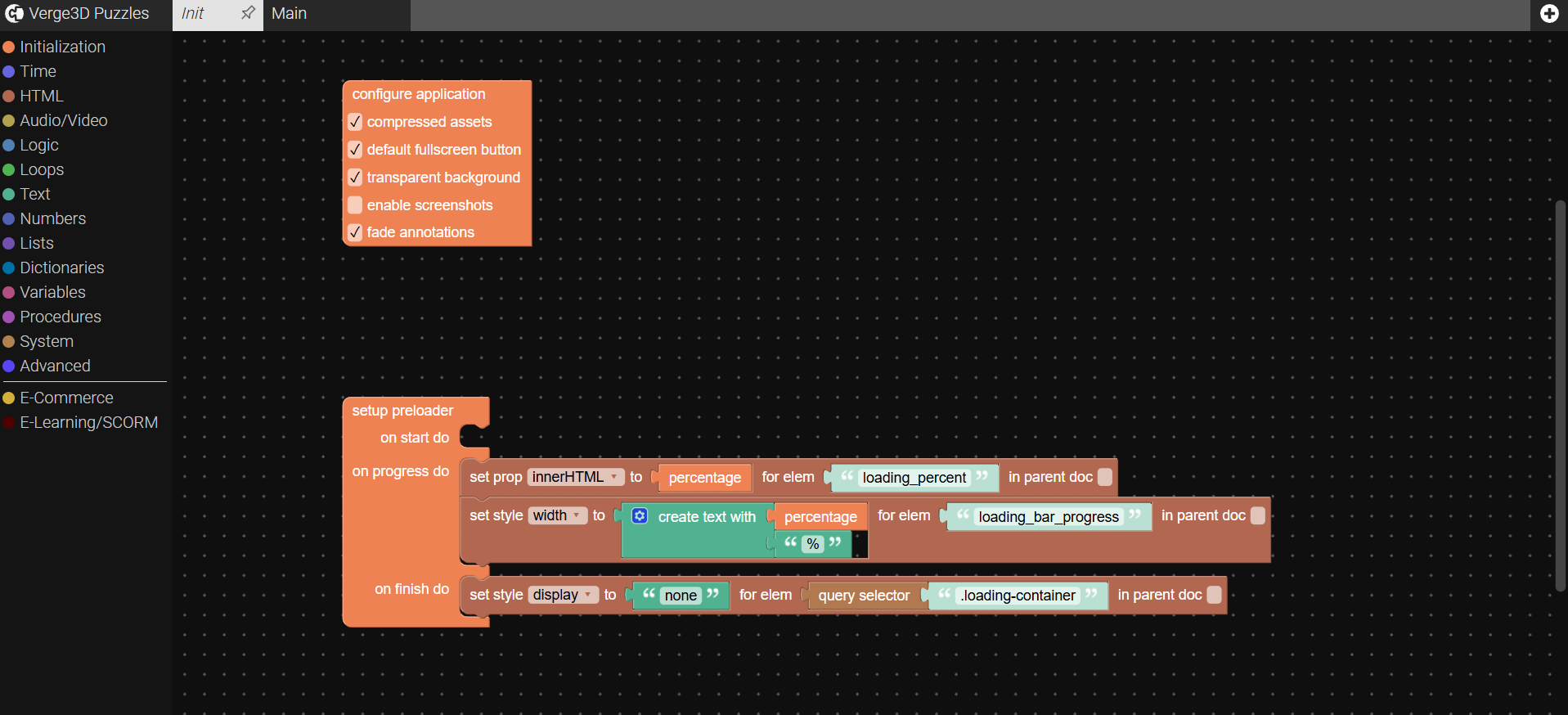

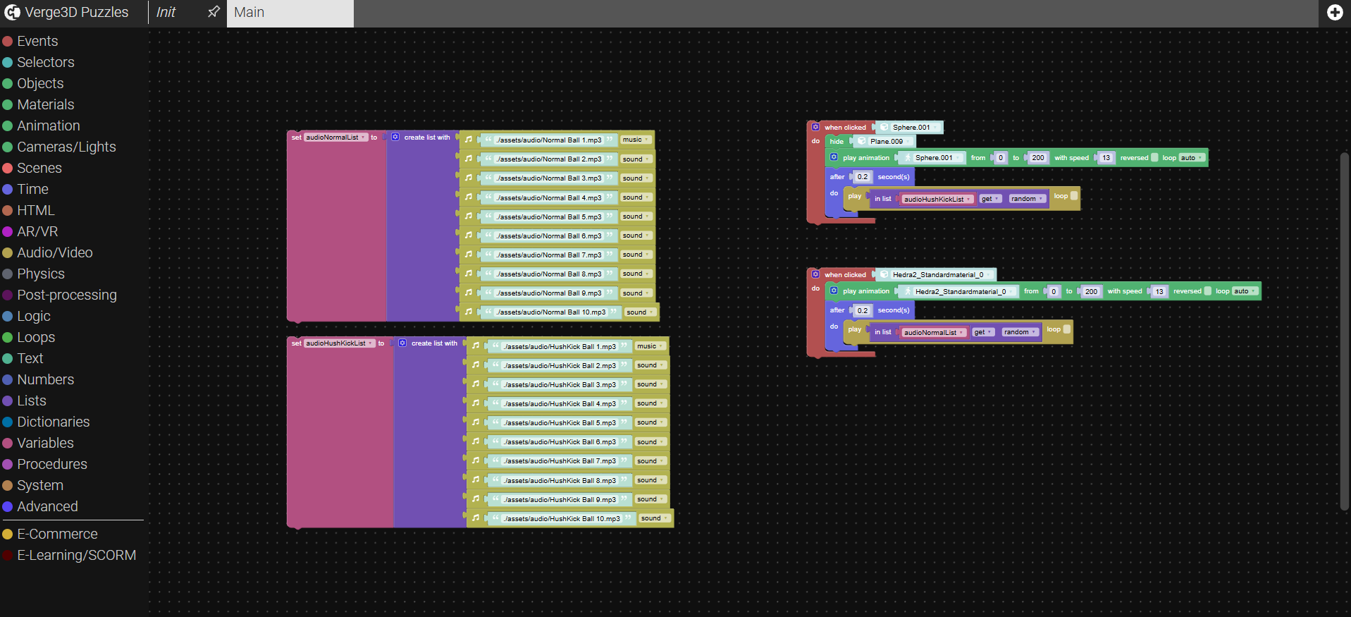

    #84216
    vergemo
    Hi Alex,
    below are the images of the puzzles and a quick video showing what is happening. I hovered for a while before scrolling down just to show that the app doesnt load unless i scroll down to it. is there a way to make it load in the background of the website such that its fully loaded when the user scrolls down to it?
    Thanks
    #84220
    Strange, the puzzles look pretty lightweight. In some cases the scenes with many materials / light probes can freeze a bit at 100% progress.
    If you wait longer before scrolling down will it demonstrate the same behavior? I mean is it the hidden iframe or maybe it’s just the scene that takes too much time to load?
