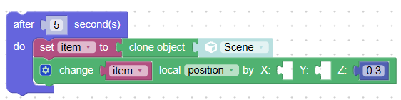

2025-03-27 at 12:23 pm #80932kdv
ParticipantDo you think it is possible to clone a complex parent-child structure
why not? easy.
2025-03-27 at 12:53 pm #80934Thomas Fabini
Participantwhy not? easy.
Thank you, then at least there’s hope it will work with cloning instead of loading, too.
But in that specific example you are cloning the whole scene… doesn’t this dramatically change when cloning a particular rig?Btw., I found your thread regarding cloning animations, it helped me rename the animation clips on the cloned, and renamed, rigs – without, there wasn’t any animation available for the new rigs which could be played – thanks for those examples, too.
2025-03-27 at 12:58 pm #80935kdv
ParticipantBut in that specific example you are cloning the whole scene
because that’s the most complex object. the left farmer is rigged, the animation of the right one is based on shape keys.
2025-03-27 at 1:02 pm #80936Thomas Fabini
ParticipantDoes this mean it would work, too if the rig is parented to an empty which you clone?
2025-03-27 at 1:05 pm #80937kdv
ParticipantSceneis an empty object.Puzzles and JS coding. Fast and expensive.
