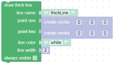

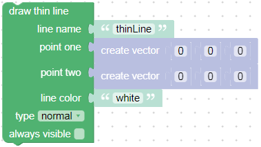

    The last two puzzles just draw lines. One of them is always 1px thin, the other one is always 2px or more thick. Their thickness doesn’t depend on the distance to them.
    https://v3d.net/9cj

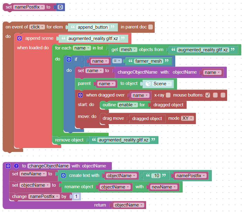

    Added an option to clone materials (in case you need to change textures/colors of cloned objects individually).
    Added the “rename object” puzzle (filling the gap in Objects).
    Added the “load file” puzzle with the “accept only” option.
    Added the “dragged object” puzzle. This puzzle can be used within the “when dragged over” puzzle only.
    Usage example:
    https://v3d.net/i2l

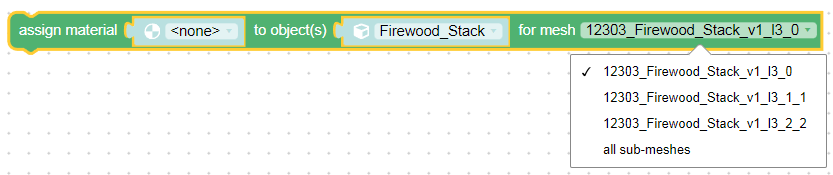

    Added the “replace material” puzzle as an alternative to “assign material”.
    This puzzle can replace any material used on multi-material meshes (not only the first one). It also prevents replaced materials from being disposed of, keeping them always in the scene for further re-use (fake material users).

    Completely re-worked “replace material” puzzle. Now it can really work with multi-material meshes as many times as needed.
    As the previous variant it prevents replaced materials from being disposed of, keeping them always in the scene for further re-use (fake users).

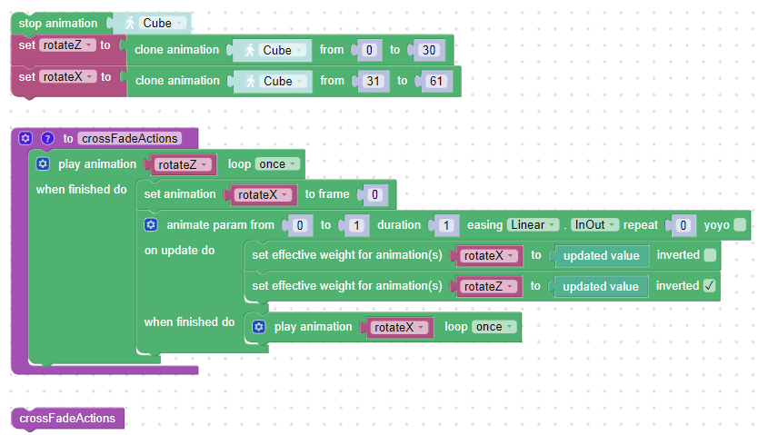

    Added the “set effective weight” puzzle for animations.
    This puzzle will allow for a the smooth transition (cross-fading) between animations (ex. between idle and walking).
    Usage example:
    Simple demo: https://v3d.net/p4m
    More advanced example: https://cdn.soft8soft.com/demo/examples/index.html?q=anim#webgl_animation_skinning_blending
